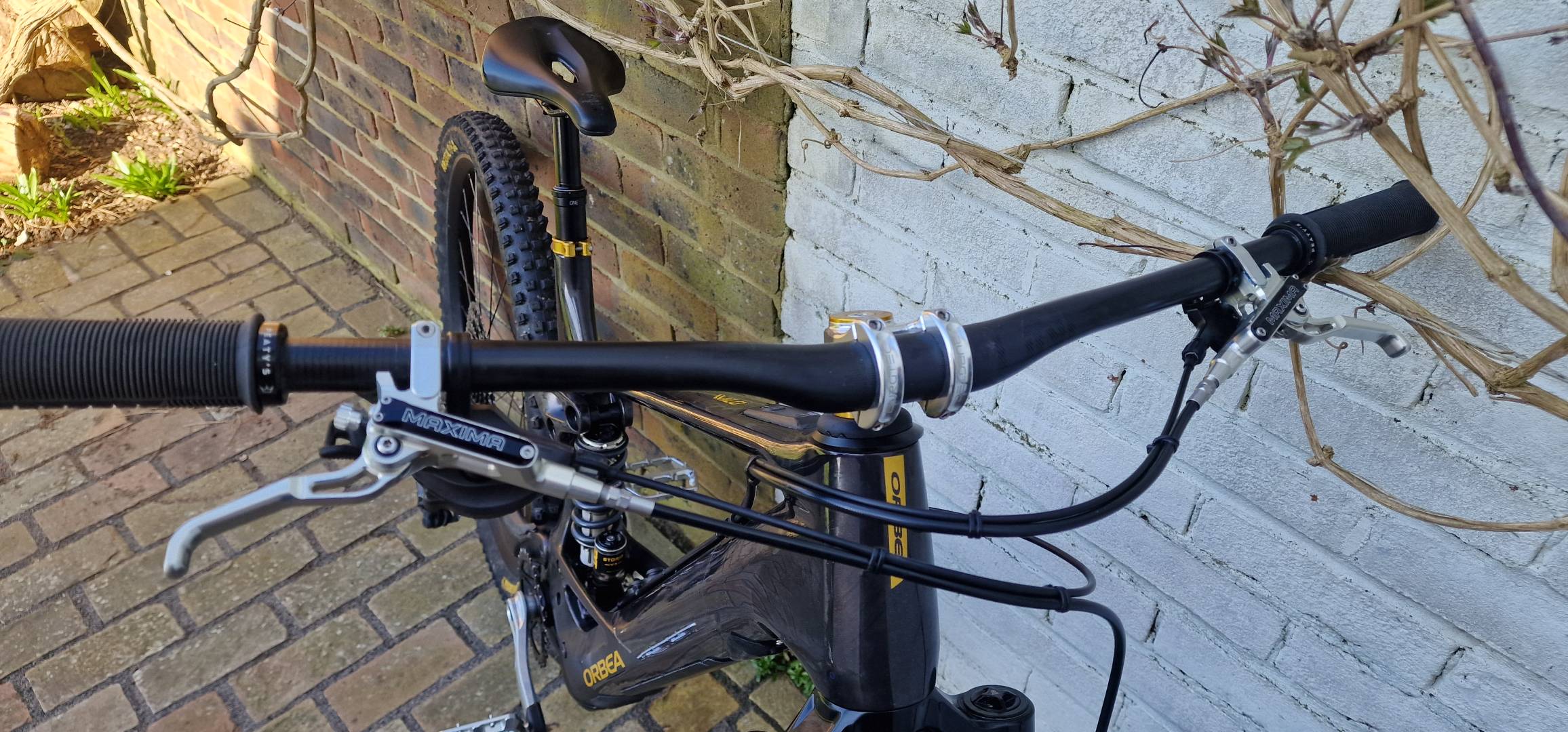

Given this thread got a bit of recent attention, I thought it'd be worth a bit of an update as the OP.
I did buy a set of Maximas (in silver/orange colourway), and have them tucked away in their box waiting for a rather special frame to arrive, which they'll then be installed on. Decided if I didn't get them, it'd niggle away at me!

Posts: 3989
Finally got them.mounted up, annoyingly the front caliper watched the spider of the TRP floating rotor, spacing it off means you don't get full pad to rotor contact. Also need to adjust the bleed as the 2.3s are wider than the caliper is designed for so think I'll bite the bullet and get some 2mm.
Any recommendations? Shimano XT any good these days? Galfer Wave? Centrelock hubs and don't want adaptors. Also don't want to spend mega money so Hopes (which may also clash) and Galfer Shark are out. These brakes are getting to be less of a bargain! Have have Magura MDP before but the rivets loosen and they rattle
 17409978459265081650702343022172.jpg Photo just cos
Posted : 03/03/2025 10:28 am
