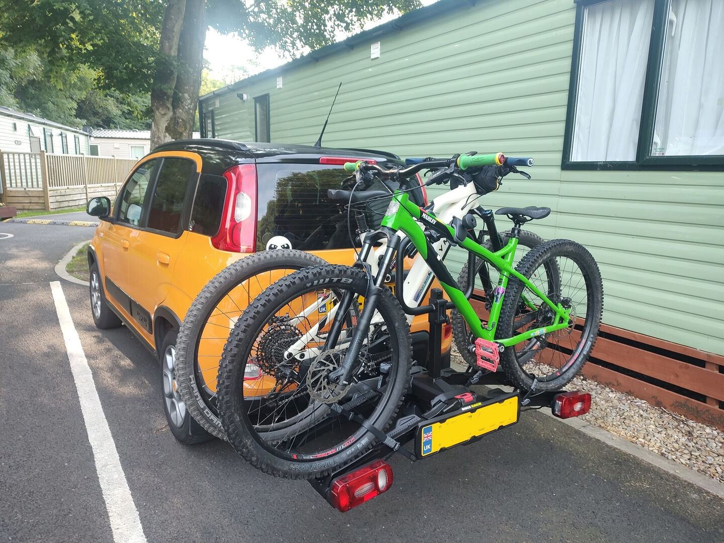

Posts: 441
Get a Buzzrack!  They're great, definitely get one that folds up for storage.  I got the Scorpion Lite 2 foldy up one and added a couple of brackets on the garage wall and it hangs up out of the way beautifully securely when it's not being used.  Very easy to install and load, a real game changer after messing around with tailgate racks for 20+ years.  Solid when it's on the car, takes my eBike and my son's bike no bother at all.  You don't need to have a tiny orange Panda as a bike car but obviously it helps 🙂
Posted : 11/06/2026 8:55 am

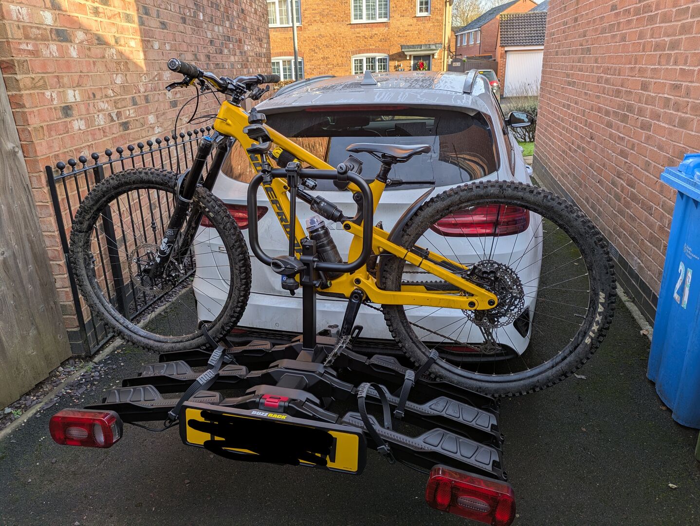

Posts: 4010
I've got a buzz-rack scorpion 3.
After years of having roof carriers I swapped to tow bar mounted December last year.
It's great, can pop it on/off in a couple of minutes, folds so I can get I'm the boot and also folds up when stored in the garage.
Also takes long bikes - my 29'er Enduro and Daughter's DH bike.
Wish I'd done it sooner!
Posted : 11/06/2026 11:30 pm
