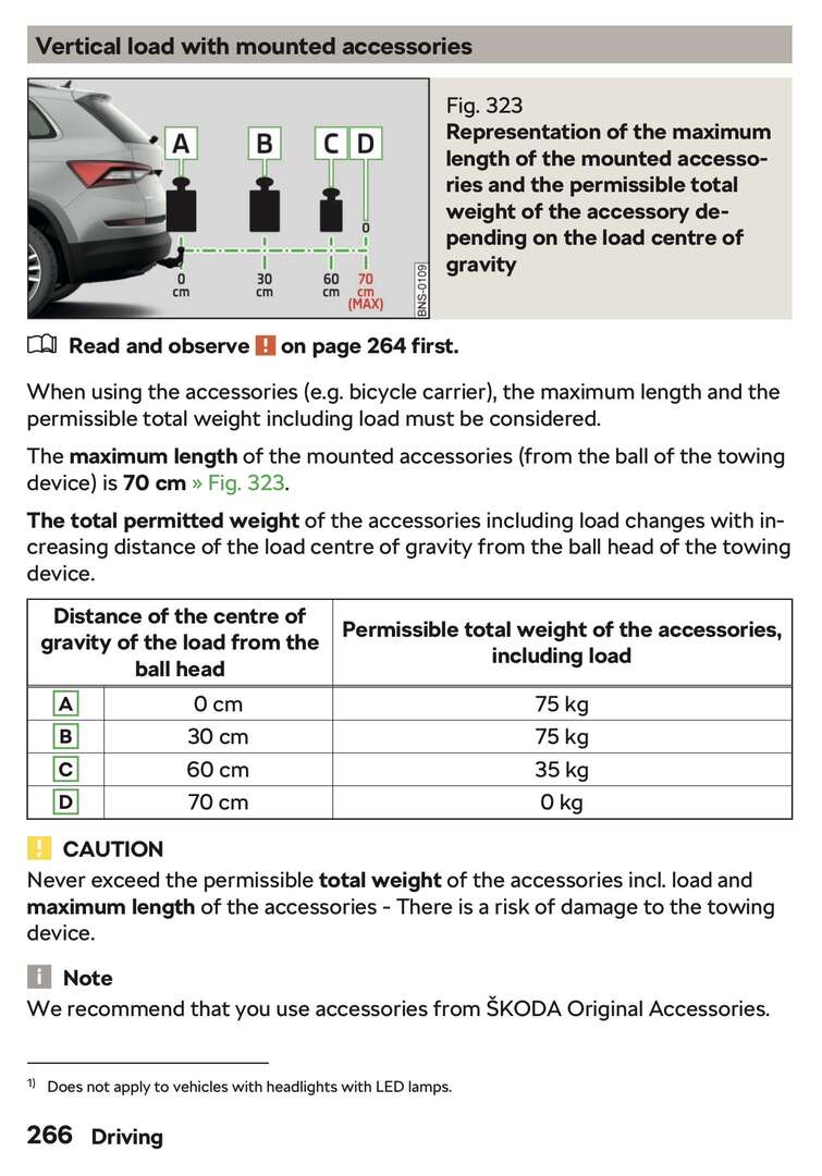

Another vote for Buzzrack here. With 4 modern bikes you also need to start keeping an eye on the max vertical weight your car is happy with

We're all good for nose loading, 100kg.

Just remember nose weight capacity ≠ rack capacity.

Our max towbar loading is 100kg, thanks to air suspension, so we've got weight to play with.
