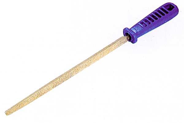

my frie nd had similar thing happen.
but the crank slipped off and mashed the grooves on the inside of the crank.
we took a small 3-sided file and smoothed off the rough bits and cleaned out the grooves. still going well years after.
