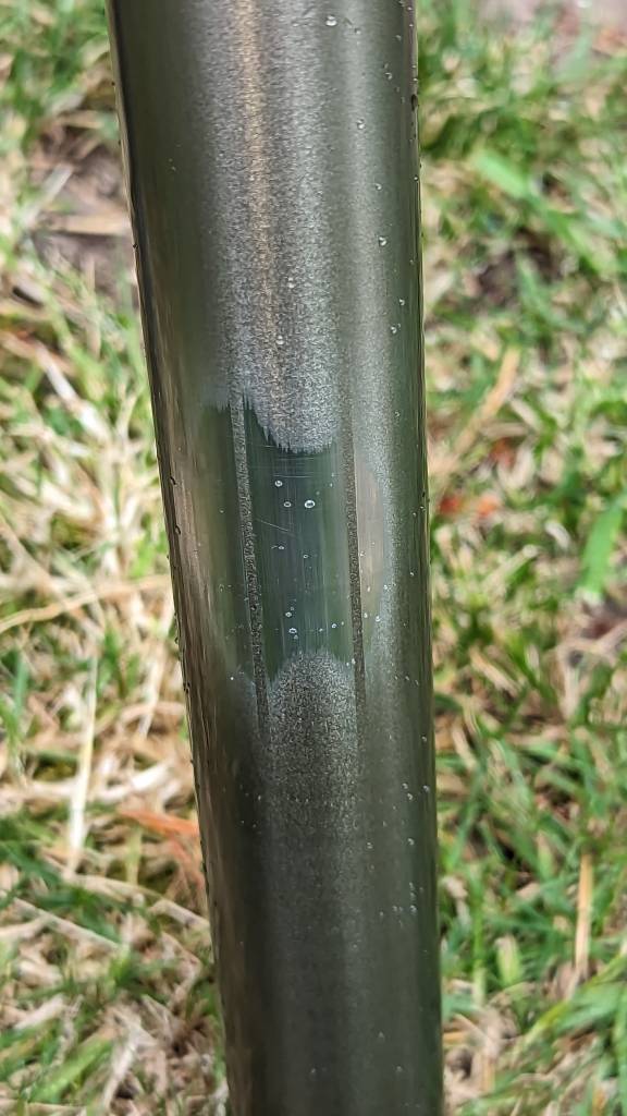

I think this might be beyond salvage.
2007 Fox32 Vanilla R 140 straight steerer.  My Google skills are failing to find a CSU that is not capped at 120mm.
No wonder it's been rattling a bit.  Fit it, forget it and ******* it. Not a bad innings of irregular servicing I suppose. 😬
I am stuffed though aren't I?
Should have serviced sooner

Well,its not going to improve, but given its a coil fork, then new lube and seals and a generak freshen up and it'll probabky carry on OK

It's hard to see what the issue is, a slight amount of laquer worn down, just keep riding it. Big gouge, fill with nail polish and sand back and keep riding it. Might leak a touch but it's a 16 year old fork.
You'll find it cheaper to buy a new fork than get a new csu ime

<p style="text-align: left;">It has worn right through the coating and those two vertical lines are where the grooves/slots in the bushings are.  There's a noticeable ridge there (maybe 0.1-0.2mm).</p>
Worth applying some nail polish?
I have a seal kit here so no real cost to re build.  They've been getting a bit clattery and I've put off servicing them due to other priorities. In hindsight bad decision and the oil in the spring / damaged leg was utterly filthy so it's probably dragged a load of filth down there.
Damper side was spotless 🙄

If you're really fond of them there are a few suspension types who replace stanchions.
RSF in Plymouth
Jtech (I think)

Since noone has suggested imminent firey death I'll finish cleaning them up and put them back together.

Totally borked, furry death imminent. I’ll offer a Kit Kat chunky to take them away for you.
Otherwise, sand them smooth and ride them until they die…got plenty miles in them I’d say.

CRC do a 130mm X-Fusion RC32 for 90 quid. With a 26" wheel in it'll be a similar length overall I think.
