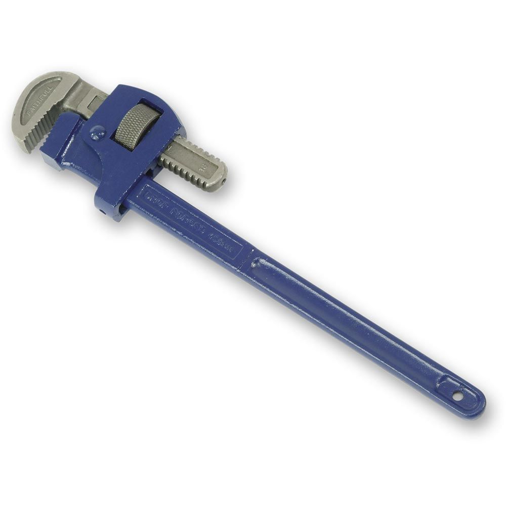

Posts: 244
Stillson worked for me. Then replaced with a proper BB.
