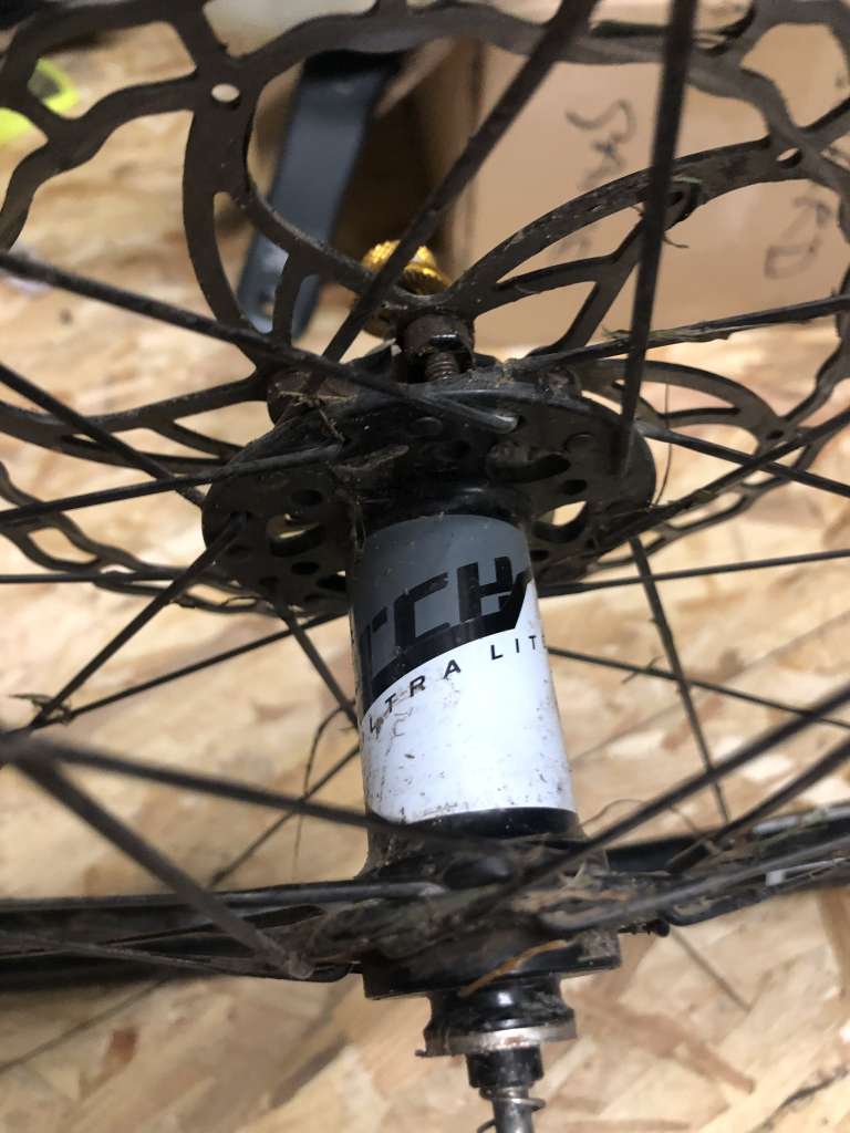

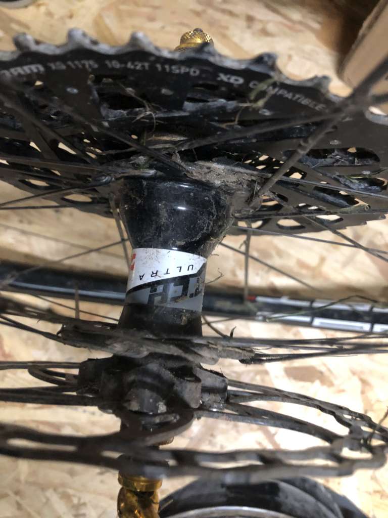

IMG_4591IMG_4593
Photo of my 'Switch Ultra Lite' hubs, well that's what they were described as anyway, possible I suppose that they ran out of stickers for the rear hub, or scammed me and I didn't notice or knew no better. Anyway, I do have some 771/2s which I'll compare them with when I find them.

Rear is switch ultra like it says…
882 hub
never did a lite rear. The front lite had smaller bearings so couldn’t be 20mm and was guess what… lighter!
its not a conspiracy, just read what it says on the thing 🤣

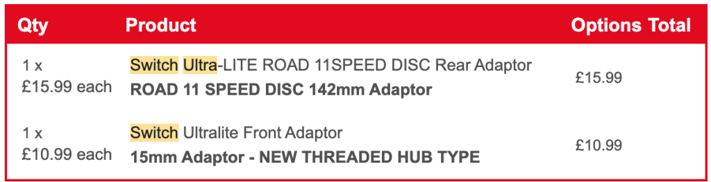

Posts: 874
What was this then?
Screenshot 2024-02-11 at 23.39.15
Posted : 12/02/2024 12:39 am
That’s a road hub not a mtb  completely different thing
