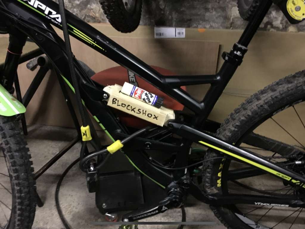

Posts: 3323
I did this on my son’s Capra when it arrived with a faulty shock
IMG_8457
