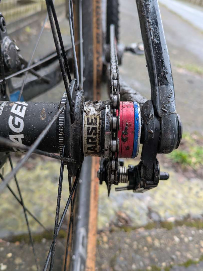

I'm not seriously planning anything, but pottering around on my singlespeed with sprung tensioner, considering what frame would fit a Pike I have spare got me wondering about the best single speed tensioner options. A few friends have ordered Marino frames from Peru, for very reasonable money,which got me wondering.
If you knew what singlespeed ratio you liked, rather than ordering a frame with sliding dropouts, could you just order it with chain stays the right length for "your" ratio?
So a regular bolt through hub, throw it in and bingo bingo it's correctly tensioned.
Or is the effect of chain wear sufficient that it wouldnt work properly for long?

I reckon the chain would go baggy. I SSed an old Ti frame using an adjustable BB and that does need a tweak.

I’ve had various SSs and have always needed to retension the chain at various times. You could potentially get away with bodging half links in and out, but that seems like an awful amount of faff.

Yeah - the golden ratio lasts only as long as the chain has minimal stretch.  You’ll need a lot of chains or an eccentrica BB.

I'd agree that it'll go slack and need adjusting.
I've had two custom singlespeed frames from Titan in China, the first I had sliding dropouts which have been been bombproof but for the second I just ordered it with normal dropouts and fitted an external eccentric bottom bracket - works a treat and looks very clean.

+ everyone else. Go as custom as you like, but get an ebb/edo.

Even with a pile of new chains, it still relies on Marino or whoever making it perfectly accurately....

Alfine tensioner. They just work.
Personally I'd but bother with a magic ratio, for the reasons above but also you will want to change gear at some point, maybe not on a commuter which literally does the same route every time, but at some point you will go somewhere hillier or flatter and what a more suitable gear, or to gear down for a much longer ride or carrying a load or whatever.

Most of the stretch is in worn alloy components. Use a decent steel chainring and rear cog plus a proper singlespeed chain and you'll get considerable mileage out of it.
I go for Magic Ratio and no tensioner and it works perfectly well unless you have a bike with skinny laterally flexing chainstays.

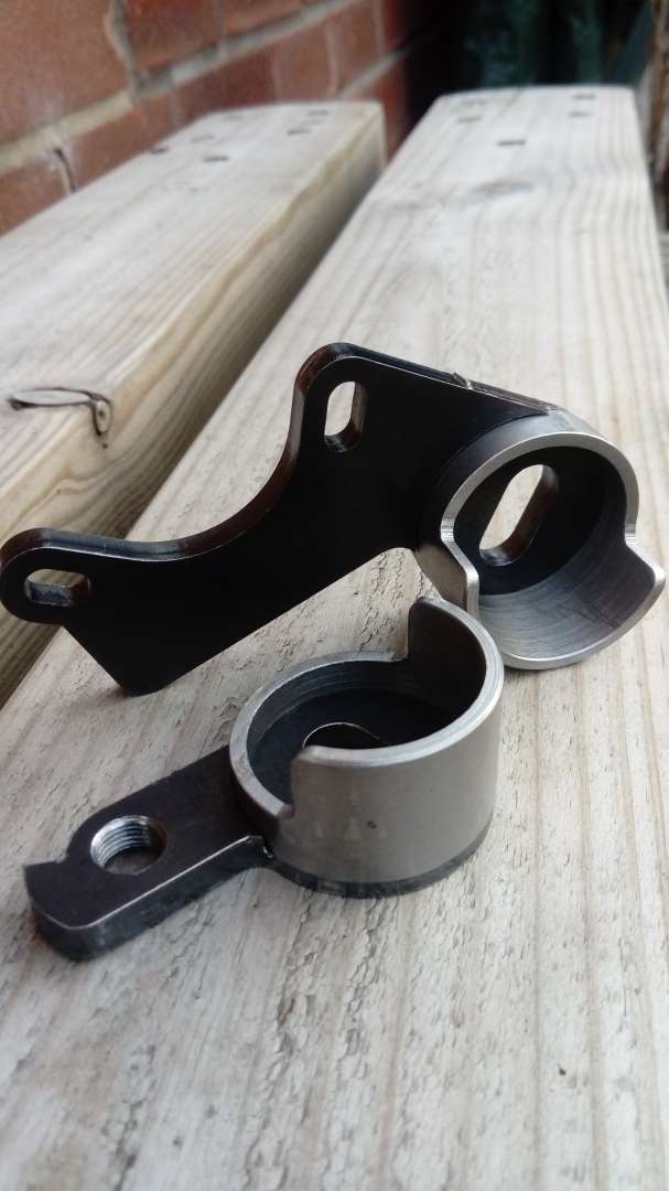

This is what I ended up with.
https://www.sjscycles.co.uk/bottom-brackets/trickstuff-excentriker/
Bought 2nd hand (obviously 😂)

I've never had much luck with ebbs. The various expanding / wedge ones always get stuck in mucky conditions as the design naturally leaves gaps that draw in silt through capillary action (same with Whyte wedge seat clamps).
SJS do a small diameter eccentric if you only need a small range of adjustment.
My favourite is a Hope hub with female threaded axle and great big M10 bolts. Plus my own closed slot dropouts. If just running one ratio you can have very short slots and can get away with regular (not slotted) caliper mounts.

I’ve had no trouble with the Rideworks PF30 conversion. They clamp between the BB faces rather than expanding inside the shell, so less chance of creaking or ovalising the shell.

But elevated chain stays are normally too flexy for a belt so splittable dropouts or a split stay are normally used.

Salsa's alternator system is a good compromise between easy adjustment and it staying put.  And in my mind it looks like it should be stiffer/stronger than horizontal sliding dropouts as it bolts up to the rear triangle, rather than being cantilevered off it?

My Thorn tandem has a split shell type and that's been rock solid for years.
