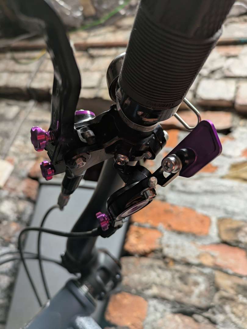

I've got one it works great and looks lovely!
It integrates with my Tech 4 lever and I don't remember buying any extra bits to make it fit

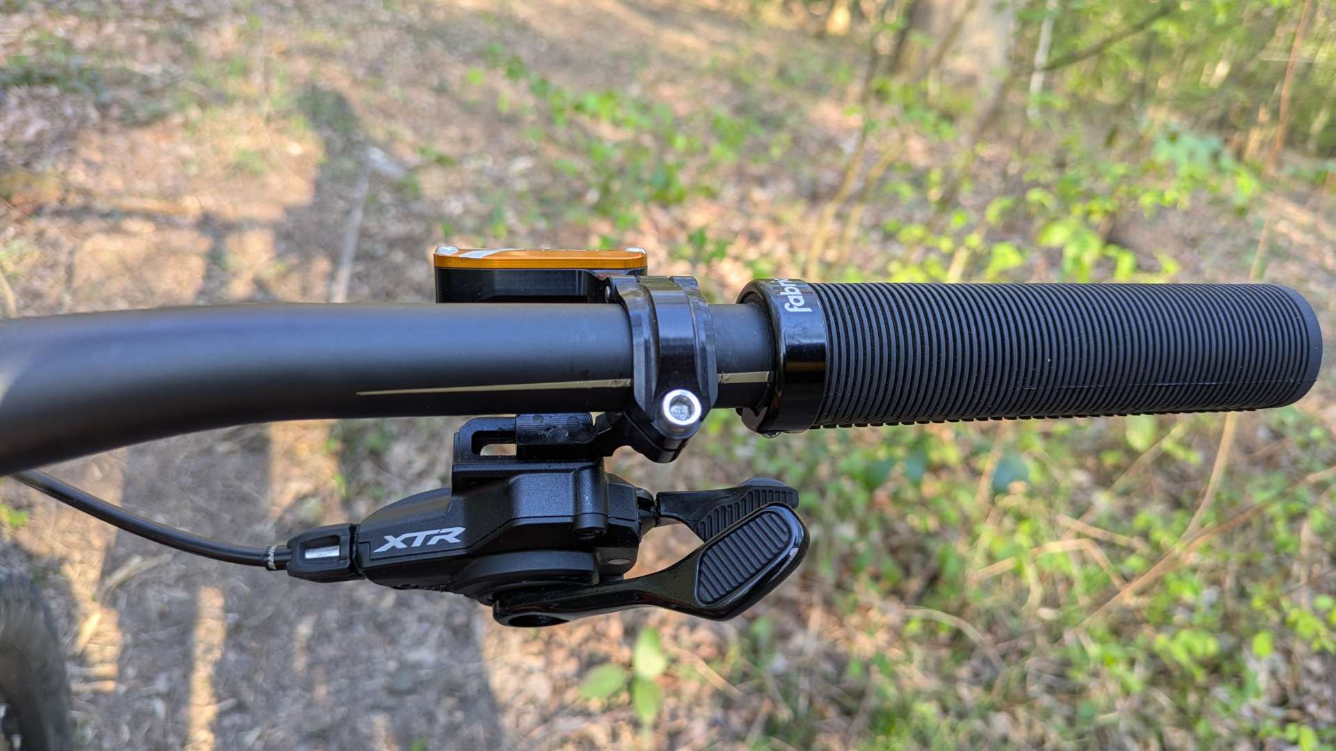

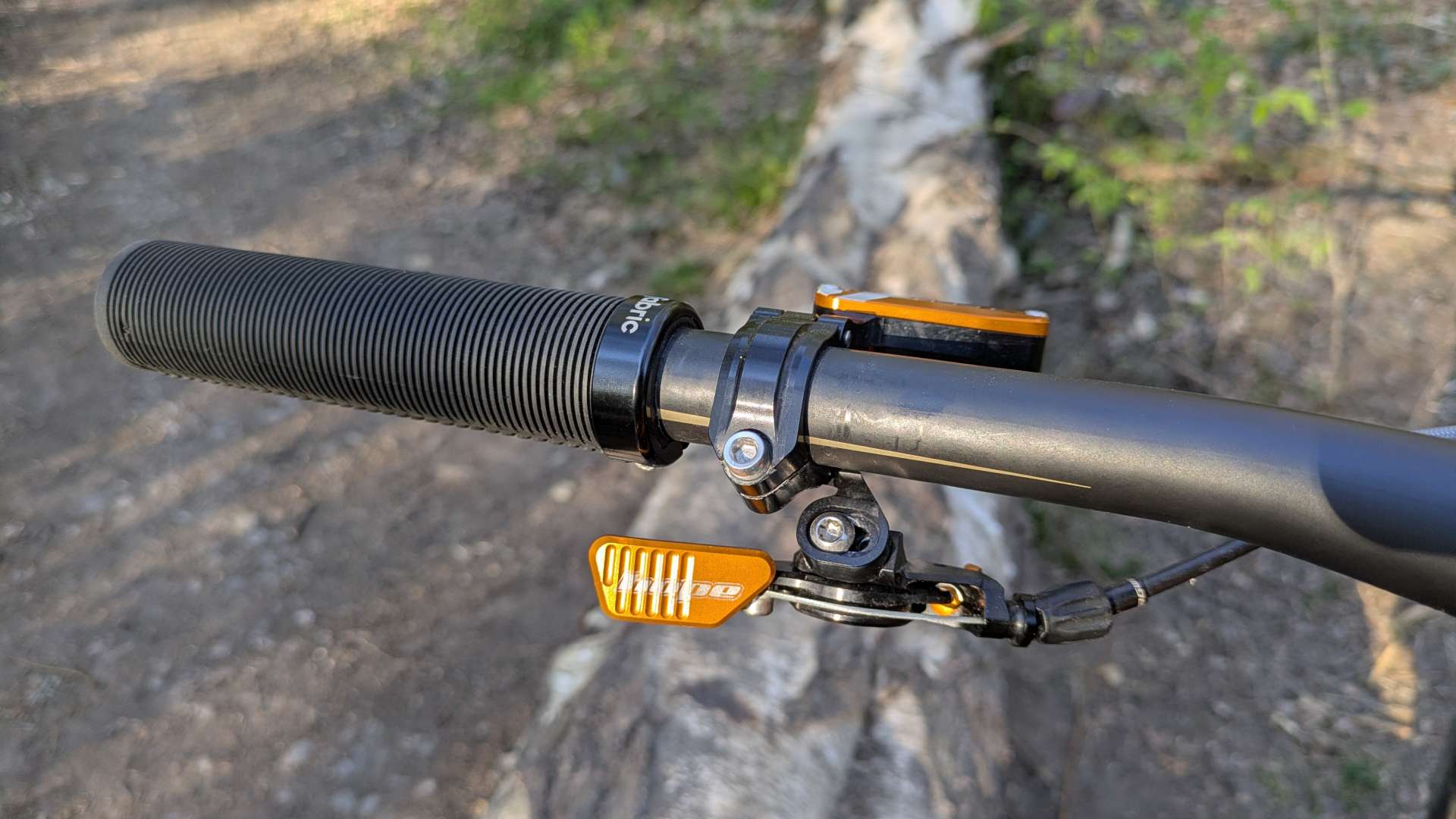

They are nice, the adjustments are really useful to get the reach and throw spot on. It does need an adapter to mount to the brake clamp but I can't remember if it came with the brakes. Probably not! PXL_20250416_144053043.jpgPXL_20250416_144039943.jpg
Pretty sure it's just the left option of these
https://winstanleysbikes.co.uk/hope-tech-4-sram-shifter-mount

What's the bell? Like that!

Not the cheapest device but it works really well and probably the nicest one on the market. I also integrated my shifter onto the brake lever as well. Makes the whole bar look a lot cleaner

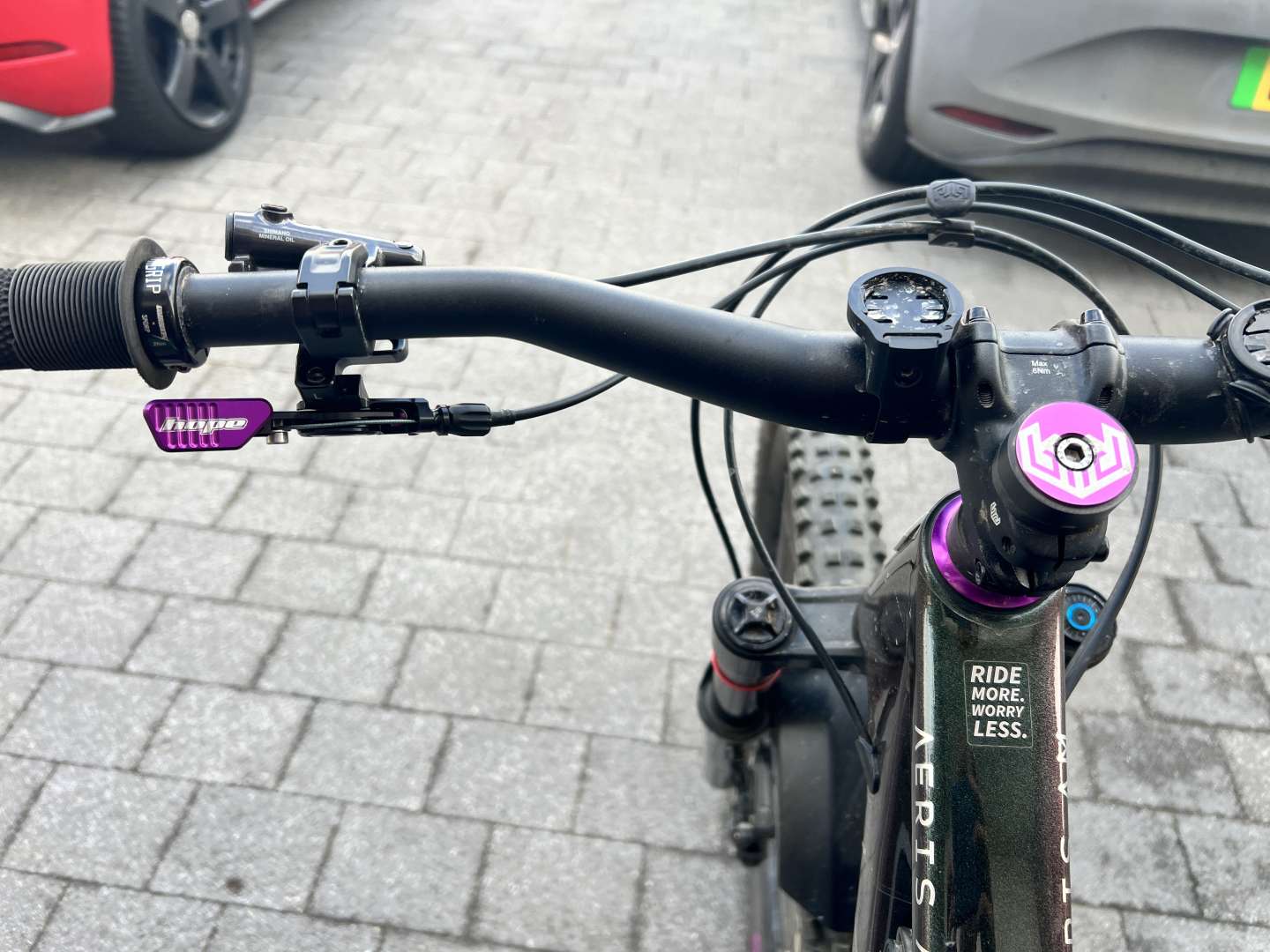

Posts: 1840
@Davros
You have a flat on your blue bike....

looks like a spur cycles one or the rockbros copy. I have several of the latter.

I think it is the rockbro's bell from eBay or Amazon. They're great. The shiny silver one is my fave.
Weirdly that back tyre wasn't flat, but it certainly looks it in that picture.
