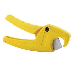

A plastic pipe cutter like this gives nice square cuts on reverb and also brake hoses:
