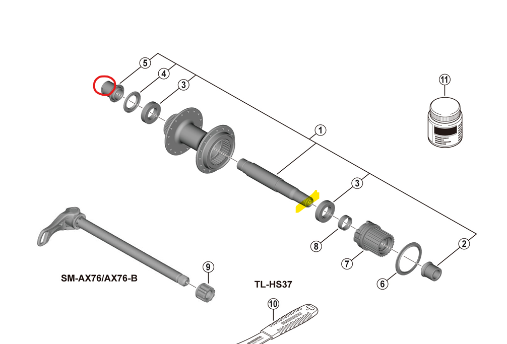

The MT410 used a half threaded axle on the rear hub.ย
Its a bit of a weird design, but can some loose pretty easily (Especially from new and not checked)
It looks like thisย
<img src=" removed link " />
Pull off the drive said end cap, and use a 3mm allen key in the hole
Then a 17mm cone spanner on none driveside, and nip it upย
Should be goodย

3mm allen key through the yellow marked hole, then tighten the red circled end cap?
Also, is it worth popping a bit of Loctite 243 on the NDS end cap to stop it loosening again in the future?

Posted by: handyman153
Yeah, it won't let me do photos for some reason 😂
https://www.westbrookcycles.co.uk/shimano_mt410-b_rear_hub_axle_kit-44597?stockid=448120&gad_source=1&gad_campaignid=19642708299&gbraid=0AAAAADtxIuxe-ofGA0CqhyOTqEuPf1pda&gclid=Cj0KCQiA-YvMBhDtARIsAHZuUzLkYC5umWiUmg_Kb6iBbL4G2blnsyNlWjxxNZanhGfvEaWJsFYQQL0aArYEEALw_wcB
Thats the axle spares kit, so you can see the bitsย
Brilliant, thanks! That confirms the question in my reply.
I'll give it a go later this evening.
Posted : 04/02/2026 5:25 pm
Posts: 397
Yep! Thats all itย
It should have some locktite on it, but it might have dried upย
No harm popping a bit more on
