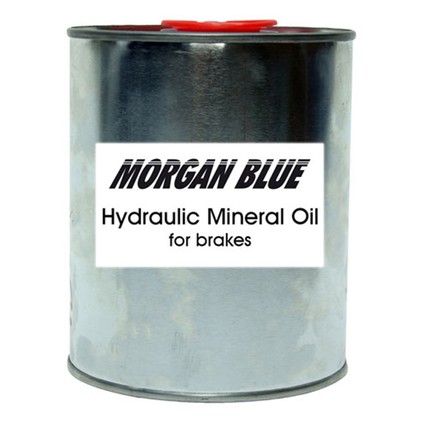

Morgan Blue mineral oil works perfectly in Shimano brakes, I've found.
Was recommended by my LBS as what they use as well.

Morgan Blue in stock here - https://www.sigmasports.com/item/Morgan-Blue/Hydraulic-Mineral-Oil-1000ml/83P5
As I said before, recommended based on several years' happy use by myself & LBS.
