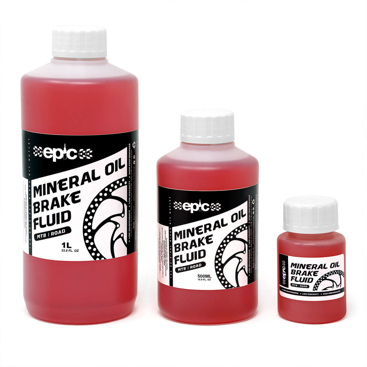

Posts: 2279
I've also used the LMH stuff from Halfords and found while it worked OK it was more viscous than the Shimano stuff so getting a really good bleed was harder and the lever feel was different; little bit slow and dead feeling. But when you squeezed the lever the bike stopped, so it was OK but not great.
I've since stopped using it and I have used Epic Bleed's Shimano compatible mineral oil and the Bikehut mineral oil brake fluid (different to the LMH stuff) in the past and that had a much better feel and as far as I can tell gives same performance as the Shimano stuff.
https://epicbleedsolutions.com/collections/fluids/products/shimano-mineral-oil?variant=30362383319114
https://www.halfords.com/cycling/bike-parts/bike-brakes/bikehut-mineral-oil-brake-fluid---125ml-169049.html
Epic Bleed solution do 3 types of mineral oil (Shimano, Magura, Generic) and the description on all of them is that they are compatible with Shimano, Magura, Formula. So I'm guessing that all those brand's brake fluids are cross compatible?
Posted : 26/03/2021 4:12 pm
