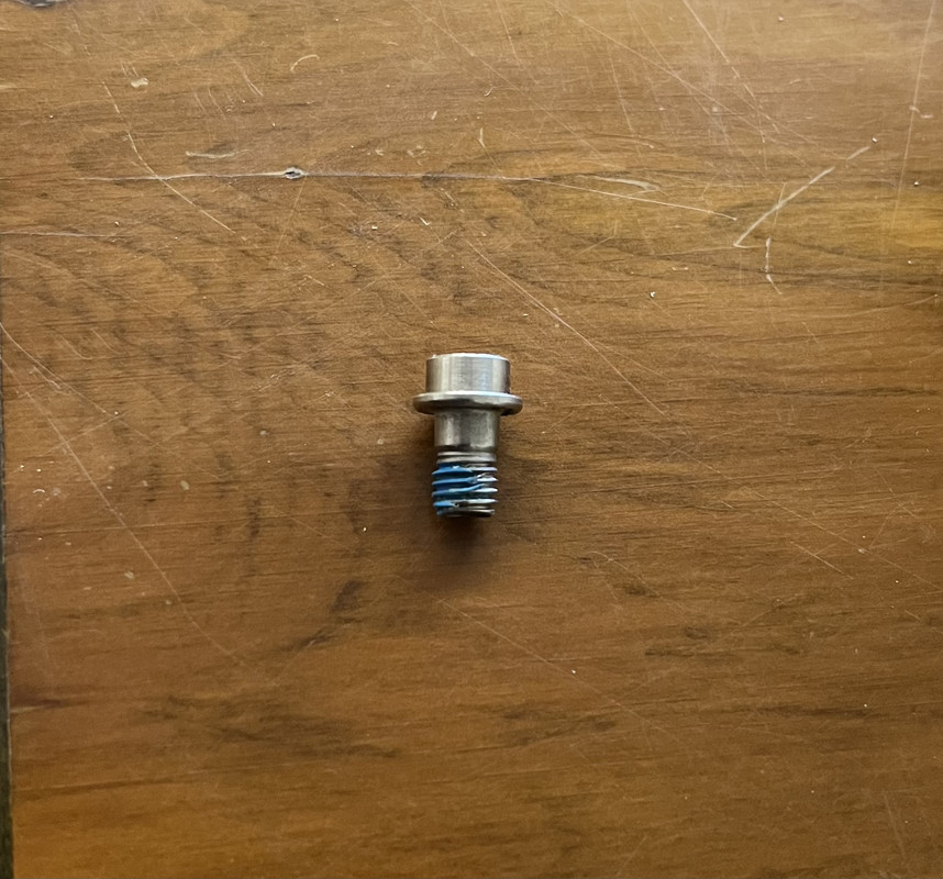

Does anyone know the size screw this is? Didn't notice that it was loose the other day and now it's worked it's way out and lost. ๐Ÿ™ It's a small screw with a shoulder on it. managed to find one one the winter bike but need to replace it.
No-one seems to have any stock. It's part number Y0GV98030. Number 3 on the diagram.

Tiny screw that holds the barmount to the shifter body

Posts: 861
This one?
Tiny Screw
It's 14mm long. The thread is M2.5 X 4mm, the shoulder is 4mm X 10mm long.

Posts: 479
@woodlikesbikes That's the one. Where can you get one?
@coatesy Thank you

I had the same happen with an M8000 shifter. Use threadlock on the replacement. You can get screws to the above spec on eBay, but personally I'd just get a close-ish match from SJS Cycles and try that.
