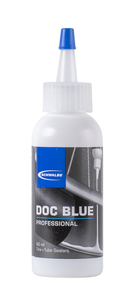

Posts: 7176

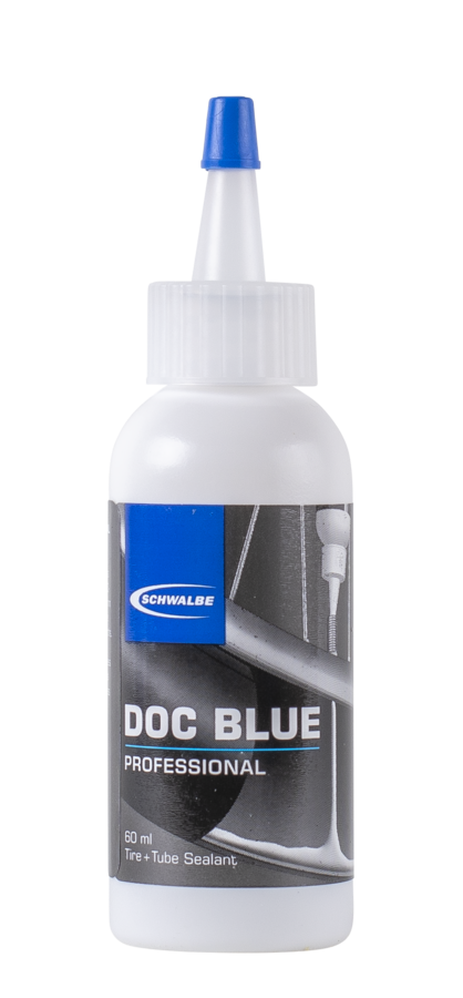

I have an old 60ml bottle of Schwalbe sealant which has a nozzle on the end; you can use it to suck up all the sealant.
Posted : 19/04/2026 5:03 pm

60ml Stan’s bottle like the Schwalbe one ☝️
syringe would be the best way, but I already have the bottle
