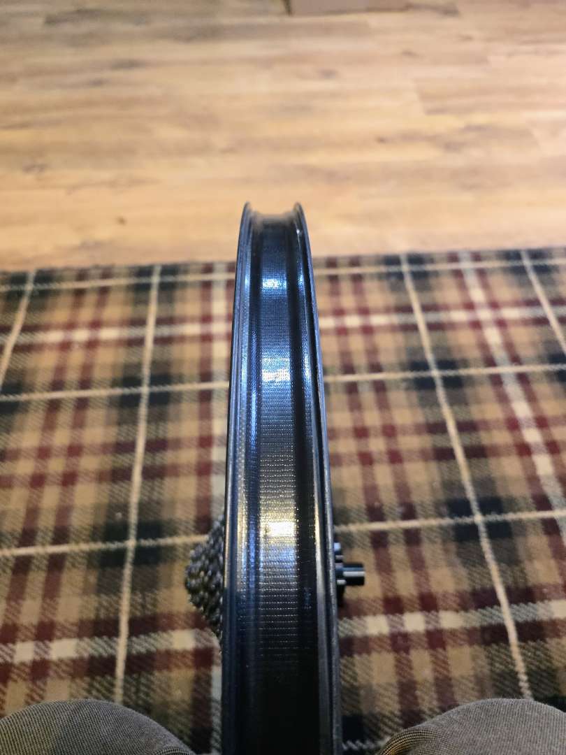

Send help
Send help
Posts: 14724

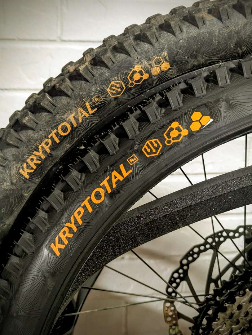

I've had some stubborn tyres in my time but this Kryptotal DH is something else 😭
Posted : 31/10/2025 11:49 am

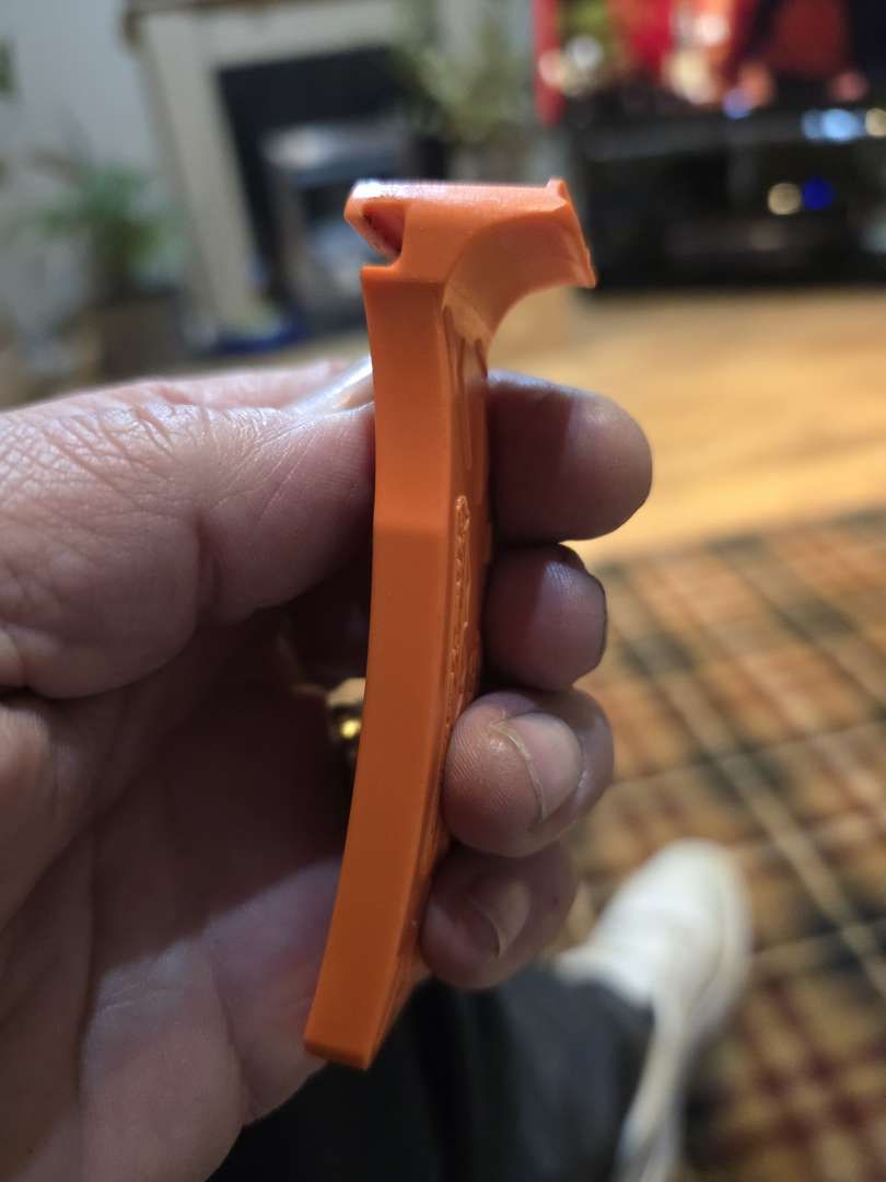

Posts: 1291

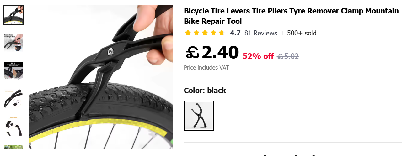

I bought these from aliexpress, just to bump the order up to free postage. Worked a treat on a Wild Gripper tyre that I struggled with.
Posted : 31/10/2025 12:20 pm

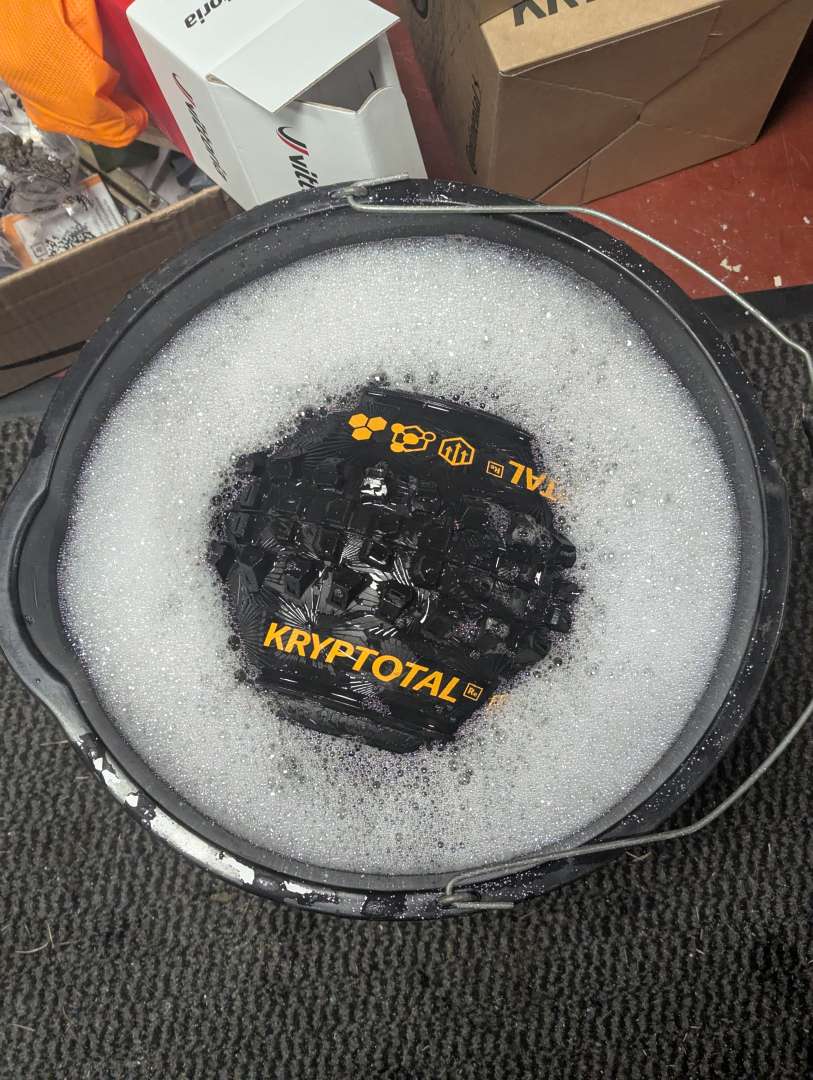

Posts: 1213
soak it in a bucket of hot soapy water then it will fit.
Once fitted they relax slightly and next time its easier
Posted : 31/10/2025 12:22 pm
Posts: 28712
Posted by: nwgiles
In summer, i put them on the van roof for an hour, winter i put them on the radiator in the house and get them nice and warm.

Posts: 8013

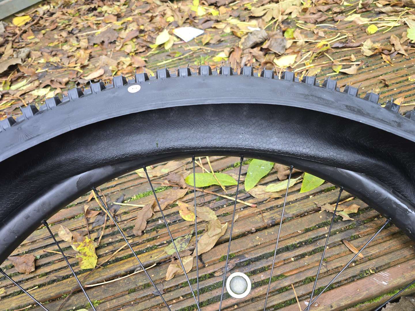

I have a technique with two tyre levers.  Use them wrong way up so the surface that normally goes under the  bead is facing down onto the rim.
Lay the wheel flat.  Kneel gently on the side where the bead is on with the open bit opposite and the stubborn bit of bead above the rim.
Put one lever at the left hand extreme where the tyre isn't yet on the rim and one on the right hand.  Tension them both upwards.  You'll need to then get one (working) lever to 90 about degrees to the rim and a bit of bead will slide onto the rim. Once a bit of bead has popped on keep pressure on the static lever and move the working lever along a bit.  Repeat.
Just 10-20mm at a time if necessary.  By putting a lever both sides of the stubborn bit you stop it going on at one end off at the other.
Maybe you've tried this already but I've not yet found a tyre I couldn't eventually get on that way.
One other thought...
Have you tried fitting it from the outside of the rim?   In the picture in the OP you are fitting the bead from the 'wrong' side compared to how it would go on if you already had a side on.  I try to avoid that with tight tyres.
Posted : 31/10/2025 11:15 pm

Posts: 14724
Posted by: garage-dweller
Yep, tried both
Posted : 01/11/2025 7:30 am

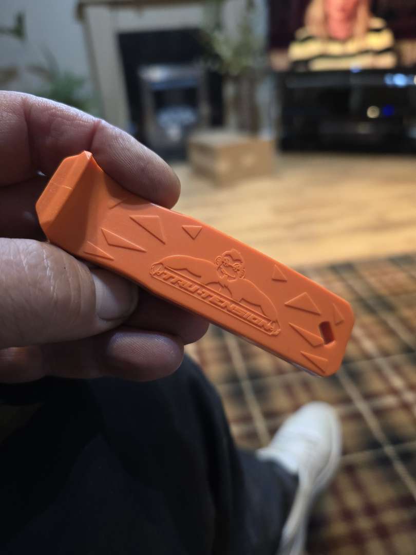

Right, stop whatever method you have with stubborn beads and buy a Tire Monkey. The end.
Just been general bike fettling in the shed, had one of these delivered from Amazon yesterday and thought I'd just have a quick look to see if I'd stand any chance making it work when I had more time. Cold tyres, no soapyness, free hand - as in wheel in one hand lever in other, not even on the floor. 10 seconds and first bead was on. Didn't go for second bead as lost a grommet off my valve.
As an indicator of how tight these effin beads are, it's currently sat right in the recess and won't spin half an inch to properly line up the logo/valve.
Posted : 02/11/2025 8:11 pm

Posts: 14724
Posted by: reeksy
Will it help with inserts?
I would imagine so. It effectively works like the tyre fitting machine for car tyres
There's no chance I'm trying inserts in these tyres though
Posted : 03/11/2025 7:11 am

Posts: 14724
Update - they are on!
The remaining three beads didn't quite want to pop on with the Tire Monkey alone, although may have done eventually. The 27.5 was worse than the 29.
But....
Posted by: joshvegas
Schwalbe flat blue tyre levers.
I'd already heeded this advice and got some. They definitely helped with their slim profile in conjunction with the Tire Monkey.
I reckon I was 5 mins a tyre whereas it was impossible previously.

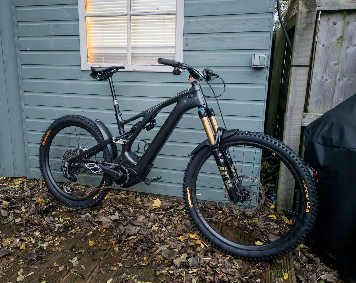

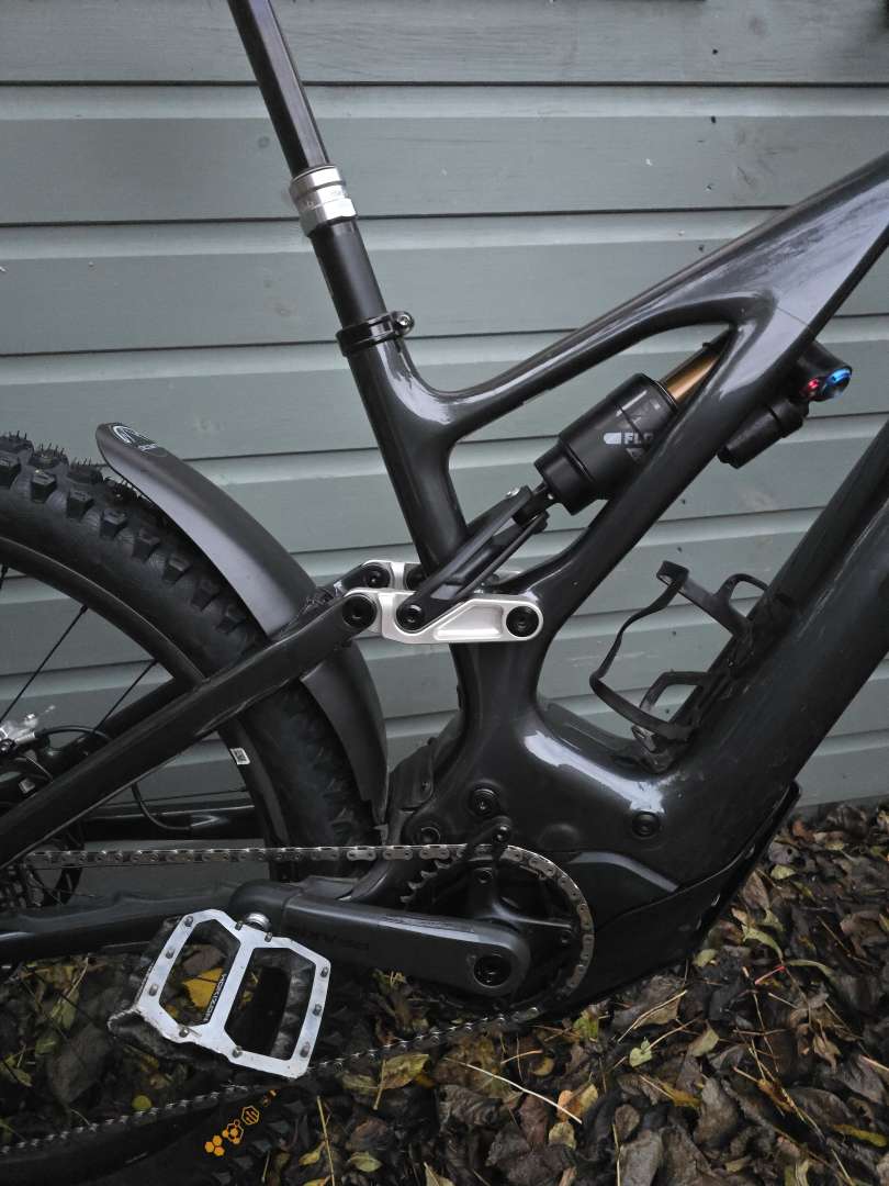

Also after getting sick of trying to get a good fit with rim tape, ditched it and went ghetto with insulation tape and gorilla tape. Anyone that isn't familiar with good insulation tape - 3M Scotch tape is the dogs doodahs.
Cascade link fitted to the Levo also - 160mm on the rear now with more progression 20251103_163545.jpg20251103_163339.jpg20251103_143748~2.jpg
Posted : 03/11/2025 6:21 pm

That was pretty difficult but not the worst experience ever. It took about 25 minutes of wrestling. Rimpacts are a nightmare on first fitting. The tyre was tight but not ridiculous.
I did soak it in soapy water for 30 minutes first which made it much floppier.
Both thumbs are hurting right now.
