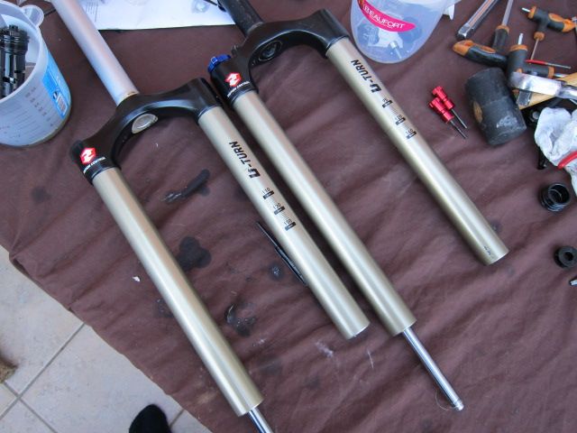

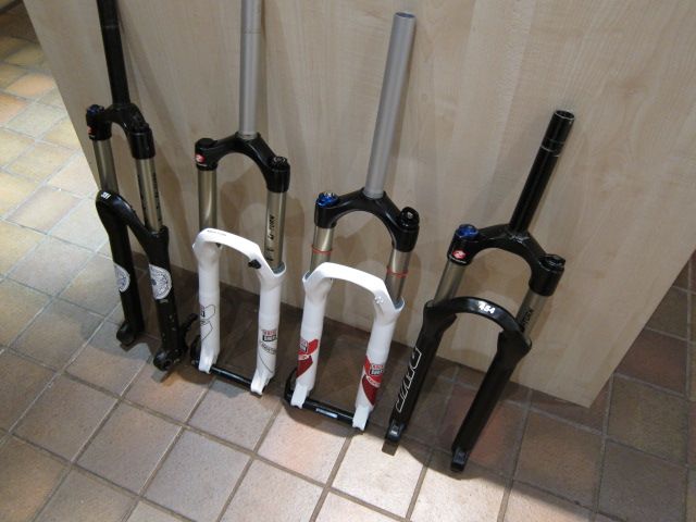

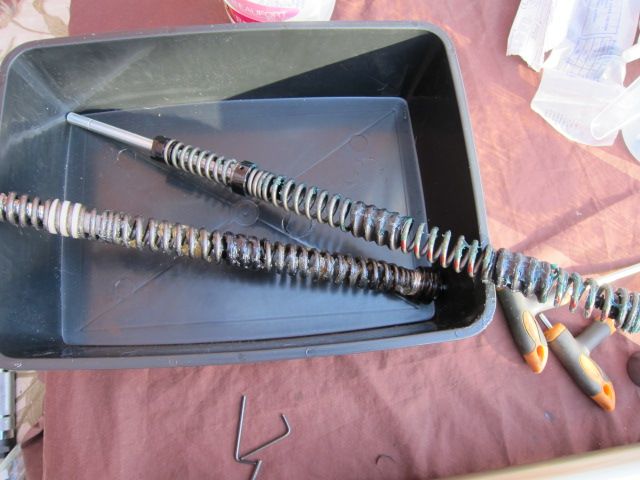

For anyone who might have been interested, I stripped these down this morning to see what might fit. (I took all our forks of our bikes incase different models/ages were different, so serviced 2 sets of pikes and 2 sets of sektors). Turns out its not possible. The Pike upper are 30mm longer than the sektors and the lowers are 10mm longer.
Which means than when you put the sektor lowers on the pike uppers you are left with the same 150mm travel as the sektors even with the shorter u-turn setup. You can't run the pike u-turn assembly in the sektor uppers either as the pike u turns have a circlip fitted base spring in the stantion (same as lyriks), on the sektors the springs run right through the stantions. (also different spring assemblys so you can't swap springs over between u turn assemblys either).
On the bright side, I was able to make up some spacers for the sektor u turn assembly to bring the sektors down to the same axle-crown as the pikes when the sektors are at 110mm and the pikes at 95mm - so problem solved. Also swapped the motion control damper over into the sektors.
So everything in the RH legs swaps over, but the LH internals are different and lowers/uppers do fit, but don't allow for u-turn.
