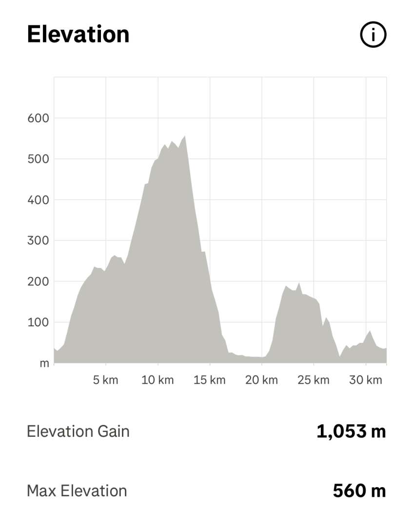

I used to think that too but after experiencing XT/XTR rotors and Shimano's finned pads (NO4C metal), I think they do make a difference. The 4-pot XTs I've got now are out-performing the Zees I had previously, the difference being I used UberBike Race Matrix pads and SLX rotors with the Zees (which I thought were great at the time).
Maybe my 'not doing anything really unusual' is a bit different, but last night's ride - which is a regular for me - didn't phase my brakes at all, whereas in the past they'd be honking and generally being a PITA a quarter of the way down.
