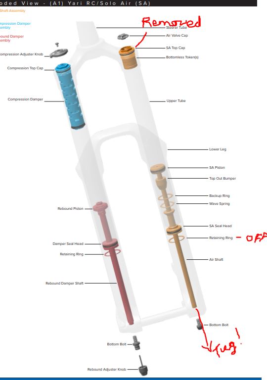

Air damper out?
You mean the negative chamber/ seal head bit?
To open that up you have to remover a circlip
Point on the diagram?

Posts: 7353
It was the air spring, yes - top cap was removed and removed the circlip. The bottom of the air spring only protruded from the stanchion about 2mm and wouldn't budge any further. I didn't want to force it!
Posted : 16/09/2022 10:17 am
Posts: 7353
Like this. So the part marked as SA Seal head, came out a very short way. Then I bottled pulling it any further, so re-assembled.
