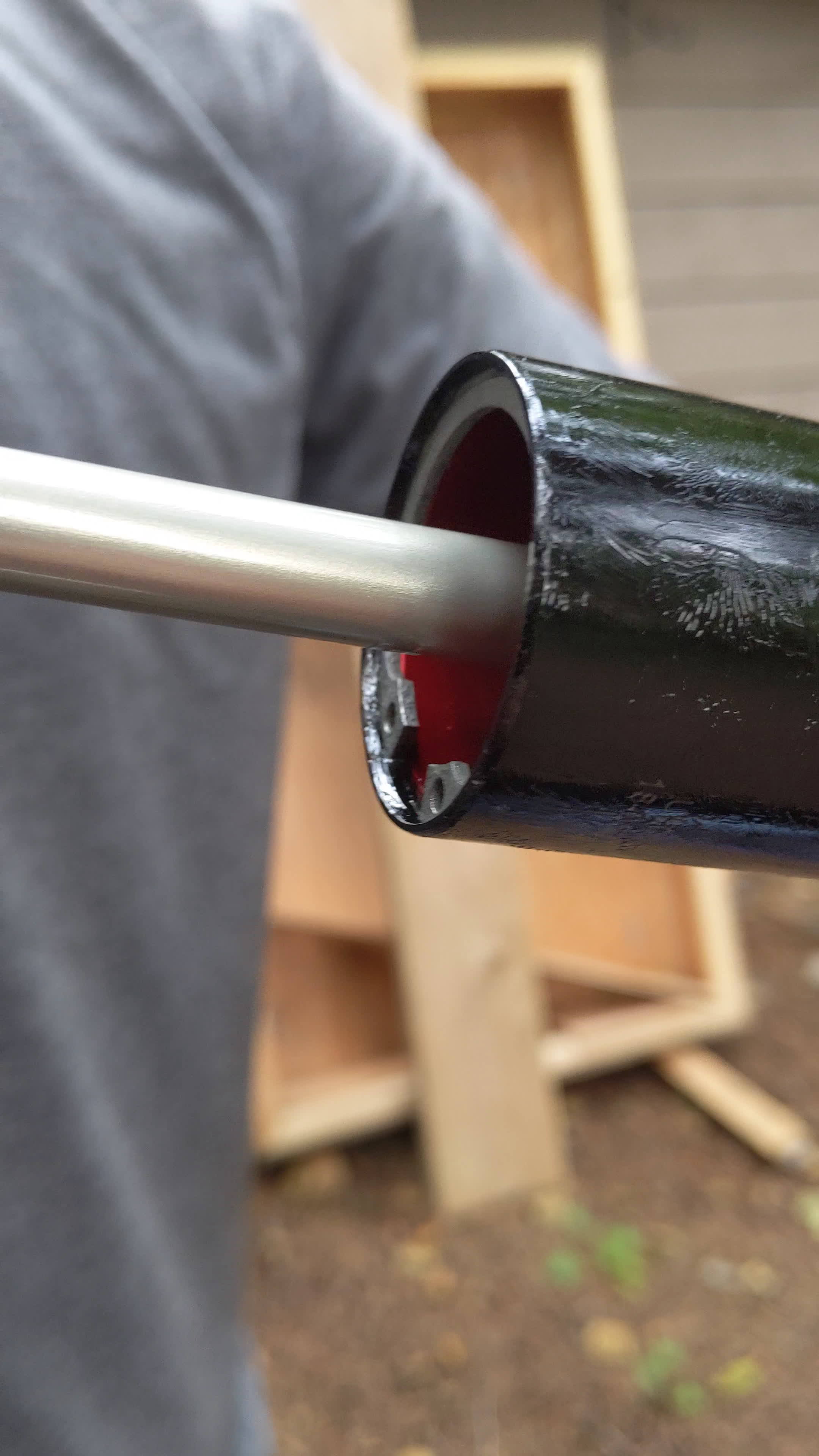

So my Lyriks are doing this annoying knocking clunking thing now. I pulled them apart. Damper seems fine, doesn't seem to be any problems with bushings, headset tight. I think it's coming from the air spring.
Anyone else managed to fix it? It's a 2018 fork with C1 airspring. Only thing I can think of is the shaft is worn or something. Maybe a whole new air spring would fix it?
Posted : 02/07/2021 5:23 pm
Posts: 6842
In case anyones wondering, I think the seal head has some play against the circlip, as mentioned here..
https://www.mtbr.com/threads/rockshox-zeb-bushing-play-knock-and-creak.1151187/
https://streamable.com/7neubf
Posted : 02/07/2021 9:39 pm
