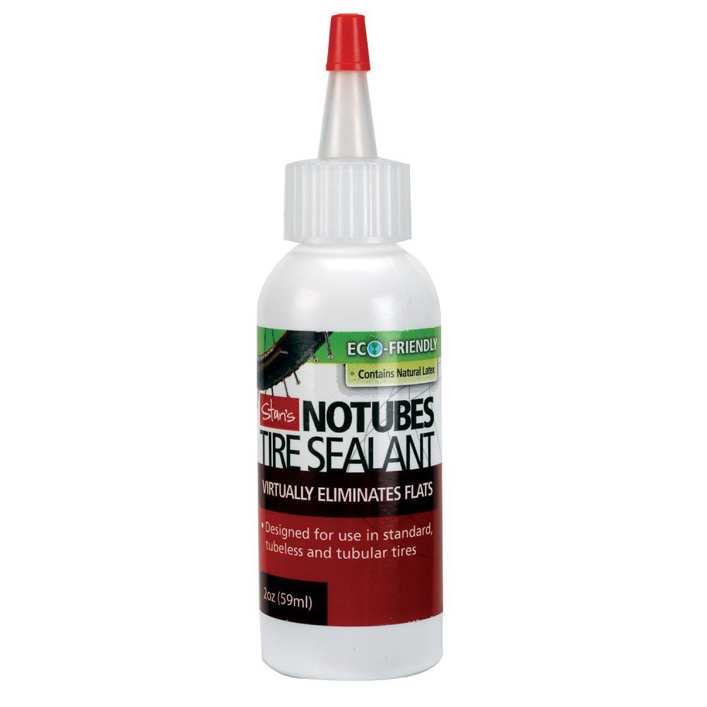

You can put Stans fluid into your inner tubes. No faff unlike tubeless and sorts out all the thorn/flint puncture issues.

How on earth do you get stans into a 23c tube?

Assuming the valve cores unscrew, I push it through a syringe and bit of rubber hose (cut from a spare brake bleed pipe).

You could inject stans into an inflated tube with a syringe.
That was meant to be a joke, but thinking about it I can't see why it wouldn't work.

Using pliers unscrew the knurled end of the presta valve.
Using a 2m allen key push the valve core into the tube, but hold it with your fingers - don't let go!
Inject the stans fluid into the valve - get a syringe and plastic pipe - like windscreen washer pipe.
Push the valve core back into the valve.
Connect a pump and give it a few strokes.
Remove pump, the air in the tube will push the end of the core back out of the valve.
Screw the knurled end back on.
Re-fit tube and tyre, inflate and go ride.
Sounds fiddly but I've done hundreds (shop mechanic) and can do each tube in a couple of minutes now.

I don't understand this. Just get a tube with a removable core, remove the core, squirt directly from the [url= ]little [/url]Stans bottle into the valve.
