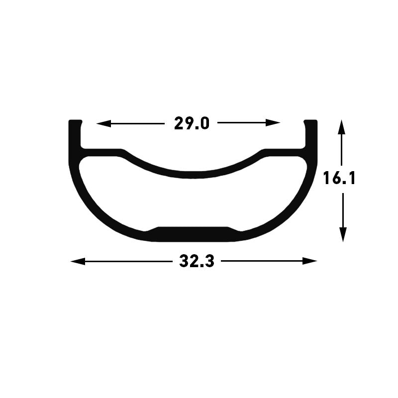

I've just built some wheels. In the end I went for stans flow just in case I wanted to drop back down to 2.35. Unless you go carbon then the rims get heavier the wider you go.
Nobby nic 29er 2.6 have a nice shape on the stans flow.
Stans flow rim. 527g, 29 internal, 32.3 external, designed for 2.35 to 2.8 tyres.
https://www.notubes.com/flow-mk3-rims
Stans sentry rim. 556g, 32 internal, 35.4 external, designed for 2.5 to 3.0 tyres.
https://www.notubes.com/catalog/product/view/id/242016/s/sentry-mk3-rims/category/174/
YOu can go wider and heavier, as above I think it's barons.

I’ve just built some wheels. In the end I went for stans flow
Yes, damascus, I'll be doing the same. Currently have some OE 35mm internal rims running 2.6 to 2.8 but have also followed Stans guidance, where they suggest their rims can run slightly narrower than other recommendations. Perhaps this is specific to their design, but in any case, it'll help save weight.
