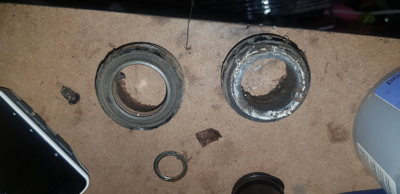

Hi guys
I'm trying to remove the raceface ride crank from my fatbike so I can change the bb to hope ( the mt800 bb didn't last 6 months...fitted by a lbs)
Anyhoo...ive removed the drive side arm and according to utube the crank should pull off OK...might need a light tap with a rubber mallet.
Well I've been pounding it for a good 5mins and it's not moving...is it possible the drive side bb bearings are stopping the crank from coming out?
Anyone had this problem or should I get my club hammer out for a proper bash

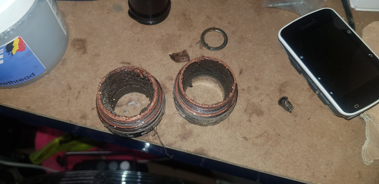

If it is anything like mine was, the axle will have gone rusty between the bearings and will fight you all the way if you try and force the axle through the NDS bearing.
Try unscrewing the NDS bearing cup as you tap the end of the crank axle so that the bearing cup comes out with the crank. You can then give the axle a good clean up before trying to remove the NDS cup from it.

Exactly what I've just did @hooli ...took a few good whacks....then more to push though the other side....the bearings were just shot...never seen anything like it in all my 40 years of riding...the new hope's are in place now ...feels like a new bike now..cheers guys

Posts: 1014
bb
bb1
