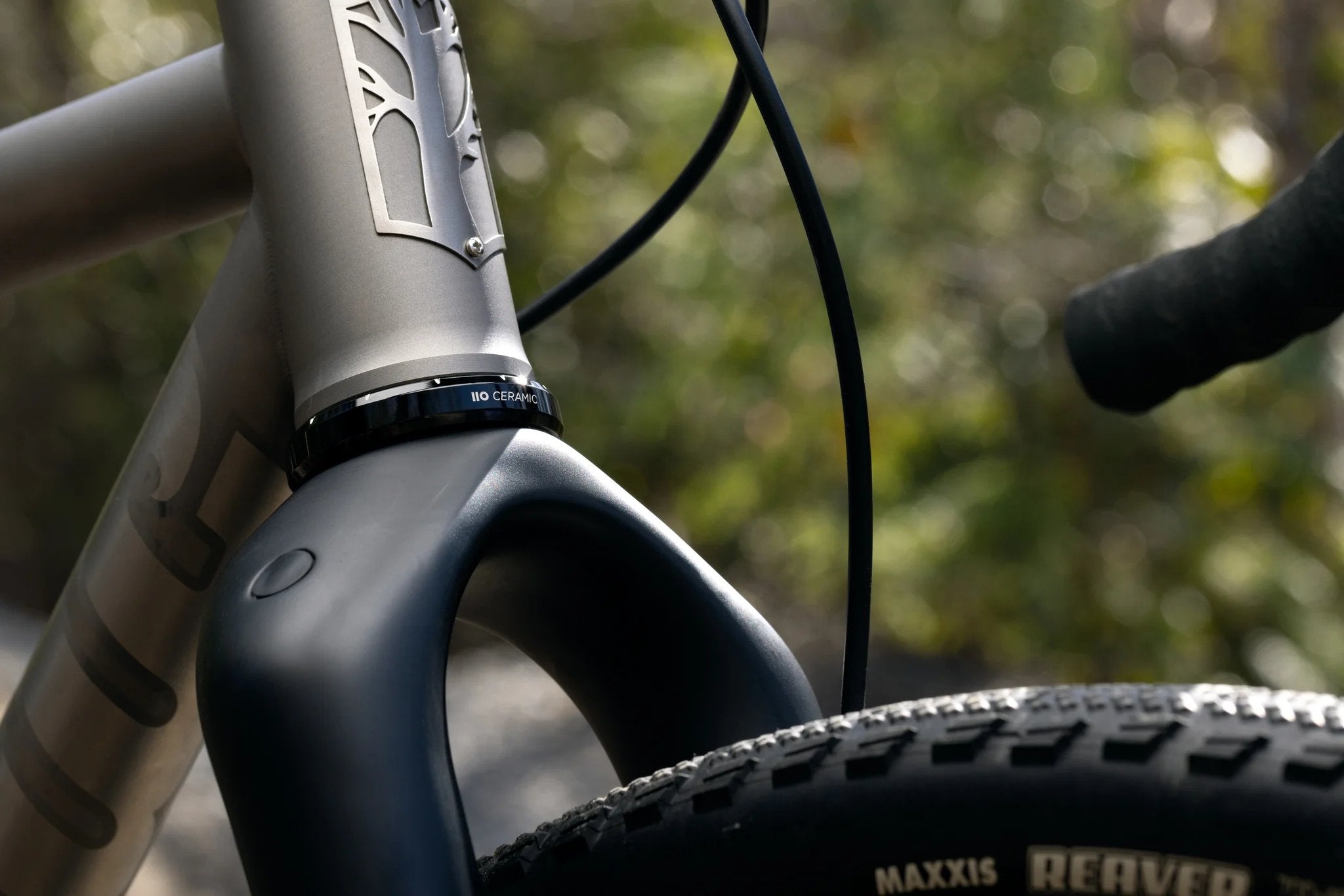

I just assumed that installing the headset would gently bend the steel back into shape.
After trying this procedure (with the first frame), my nukeproof bearing breaks. Not the headset cup bend my frame, my frame bend the headset cup.
[img]
[/img]
The nukeproof headset is equipped with an industrial standard bearing, so you can´t normally see the ballbearings or the inner race.
And i think, that using force to fit on a part of the bike which is so critical than the headset is not a good practise.
And you should keep in mind, that a bearing could break due to the long term stress. caused by the transverse force on the bearing.
A bearing, which is stressed with force it is not constructed for is the quickest way to destroy the bearing.
