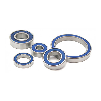

Thanks all. Will try some new bearings - Sigma have Enduro 2437s, which I think they are, need to double check, at £2.70 each so there's little to lose in trying another pair: https://www.sigmasports.com/item/Enduro/ABEC-3-2437-Bearing-Single-24x37x7/5G9Z
Being able to replace the bearings was one of the reasons I went for one of these over another cheap Shimano one, but there's only point in doing that if the bearings are going to last a reasonable time.
