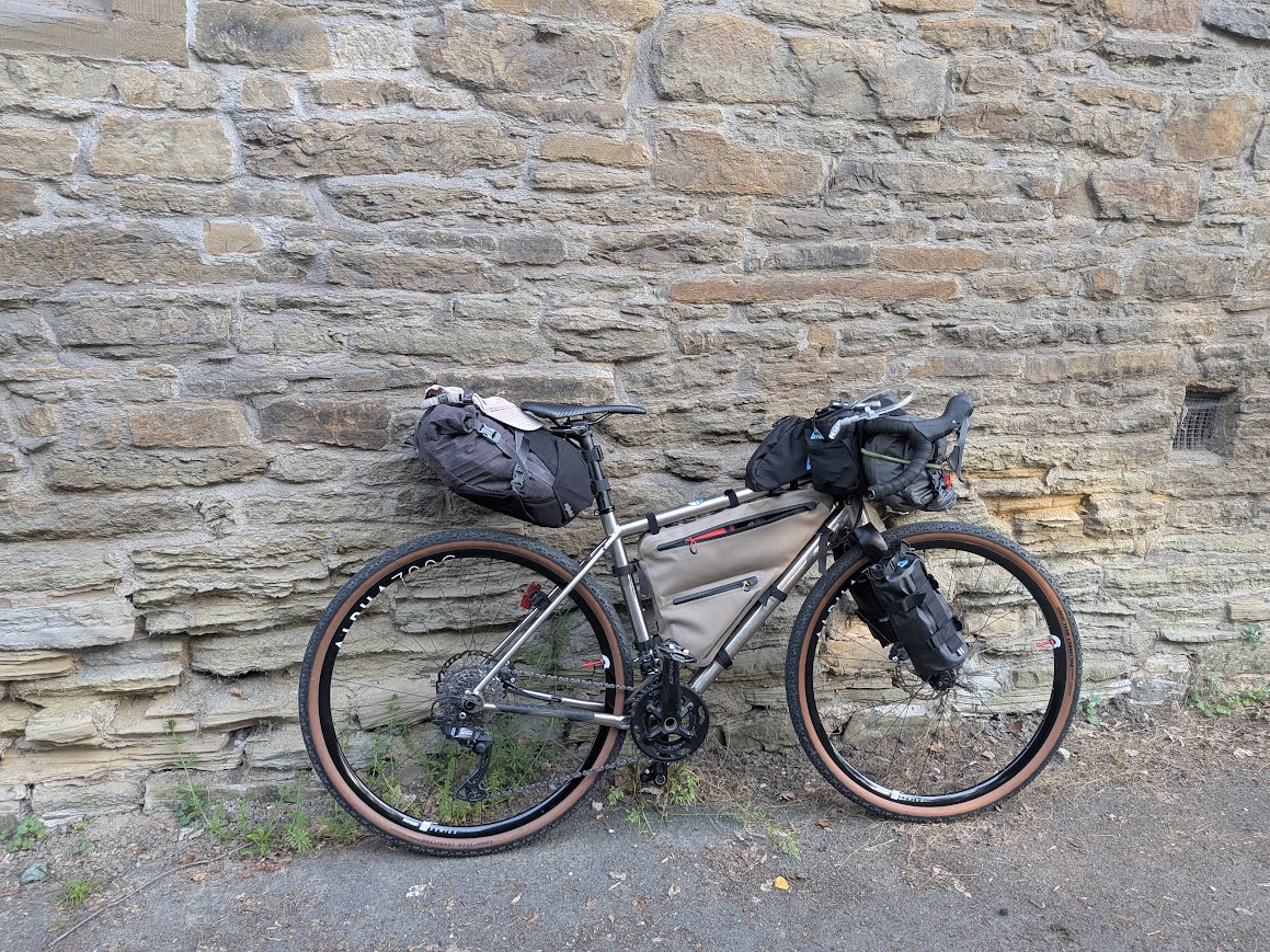

Following my speed wobble issue, I'm going to move more weight forward when I tour. 30% road. 30% forest paths. The occasional ill-advised single-track fun while loaded because shits and giggles.
Regularly carrying most of the kit for two people, and one does not travel light 😉 . I already have decent sized 9lt bar bag and a half frame bag. Plus two rear panniers.
I'm thinking tent (2kg) moving to the front will really help, possibly a sleep mat.
I've only got a single fork leg mount each side (Genesis steel fork). The lighter and simpler solution seems a wee porter/pizza rack at the front and move tent to that.
But, fashion suggests that two fork mounts are popular, and I could see the tent on one side and sleep mats (1.1kg) the other side might work...?
Any one experience of both?

My usual bike packing setup consists of
seat pack
bar bag
frame bag
snack pouch on top tube
my last bike packing trip I wanted to reduce stuff crammed into my seat pack so I invested in a some of these
https://www.topeak.com/global/en/product/1129-VERSACAGE
and these
https://www.topeak.com/global/en/product/1746-FORK-DRYBAG-4L
Installed onto the bosses of my carbon forks (they do also come with clips / attachments to attach to forks without bosses and feel like they would be solid as) paying very close attention to the recommended weight limits because carbon makes me paranoid, I managed to move sleeping mat, bivvy + tarp plus jet boil and aeropress from my seat pack to the front forks
long story short, I was amazed at how much nicer the bike was to ride and move around by hand with all the weight distributed (relatively) evenly from front to back, plus it makes it so much easier for me to unpack and pack my sleeping gear and get a brew on without having to haul everything out of every bag first
would definitely recommend fork bags / cages
