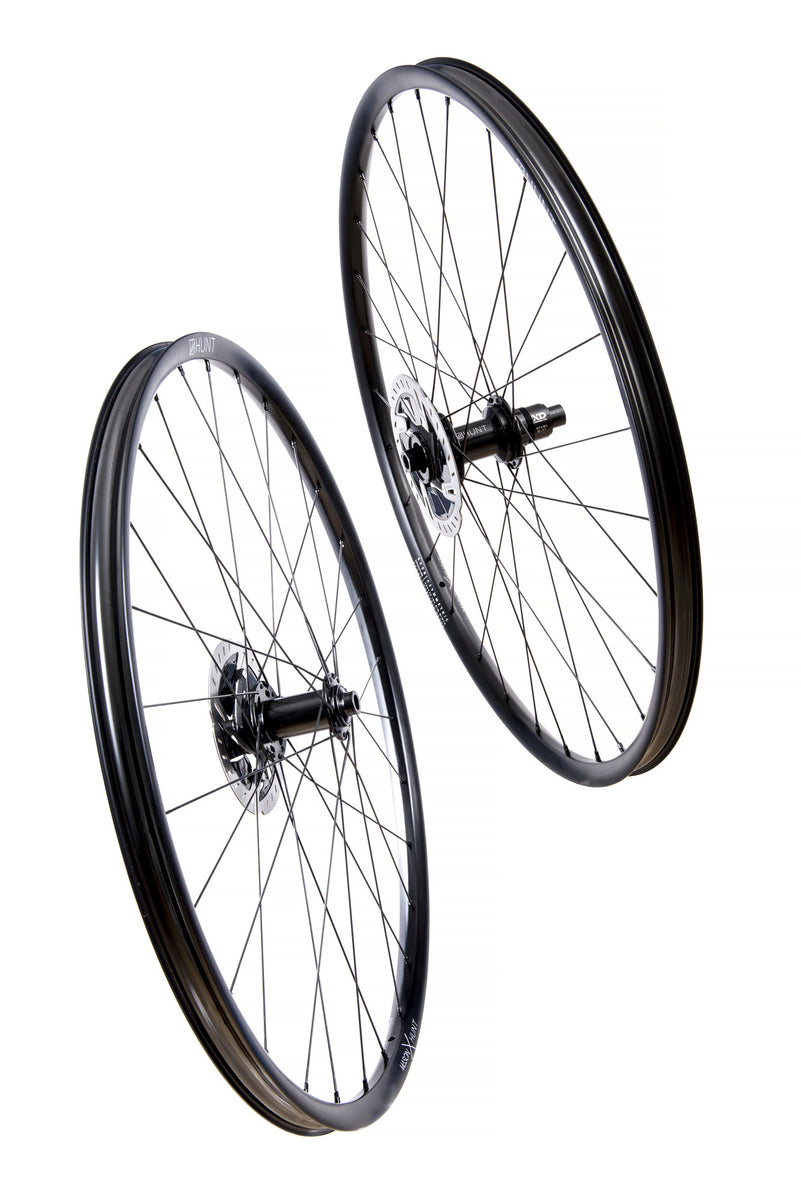

Posts: 522
Think these wheels would be ok: https://www.huntbikewheels.com/products/hunt-650b-adventure-sport-disc-27-5-gravel-road-trail-wheelset-1579g-24deep-25wide?utm_medium=cpc&utm_source=google&utm_campaign=Google%20Shopping&gclid=Cj0KCQjw84XtBRDWARIsAAU1aM0ToxxANx6jfcLDrlQrMZwlF_J9Ns3b0H4UzMvN8vOZjkXBkBVYE9kaAvWlEALw_wcB
Probably weight saving over stock. Think PX are also rolling out FSA 650b Aftrburners for less than £200 a pair, and think you can get adaptors for 9mm QR, or through axles standards, but you'd need to check before buying. Adaptors definately available from Hunt if not already in the box...
