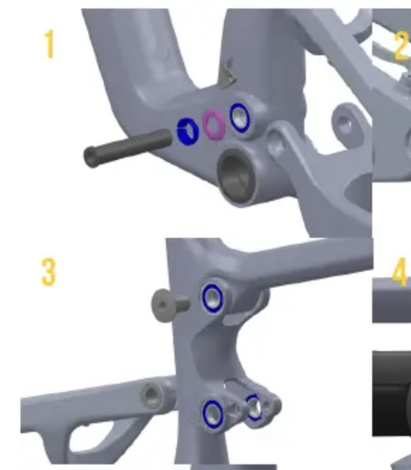

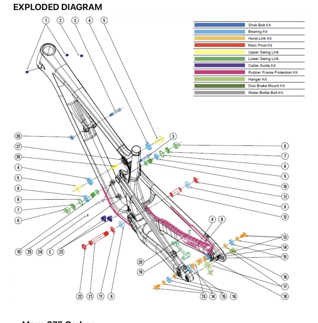

Front shock linkage - is there a right way around for part 28?  I've got a little scallop showing in front of the bolt on the outside and that doesn't look massively tight in its hole.  (but it's a clamping action so shouldn't matter if it's tight)
(these are the only images I can find now as the nukeproof site is down - from manuals.lib)

I've got the exploded diagrams as proper files, if you need them I can send via email.
