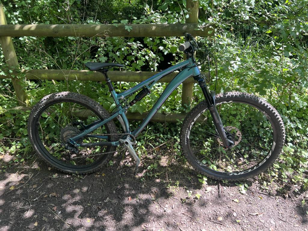

So thinking about swapping my shock on my Hammerhead Thumper (remember those!)….supposedly 130 travel.
Currently running offset bushings 190x51 shock (stock is 190x51 IIRC). Flipped it upside down, measured rear axle to ground at shock full extension, then again at full (air out) compression. Only measures 100mm difference….therefore does that imply 100mm rear travel?
Planning on using offset bushings 200x57.
Is my measuring at fault or something awry with travel?
Banter and pointing out the obvious very welcome.
Chris
Posted : 16/07/2023 1:56 pm

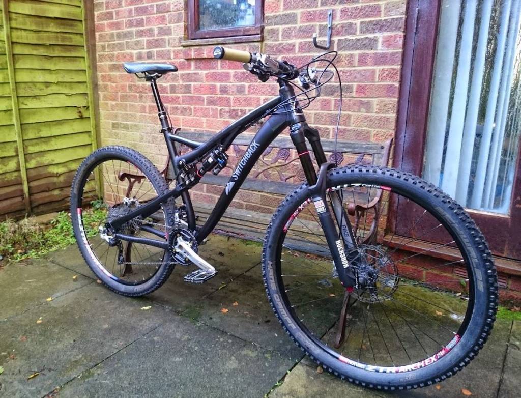

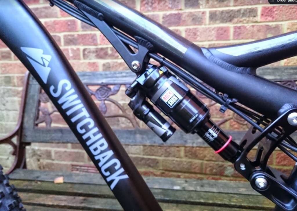

Nothing to add other than I had a Switchback Unveil9 which I think was the same frame, nice bike, did ~1000 miles on it
Ooh and due to the wonders of Google Photos, simply typing in "switchback" it has found my photos of it in my backups, here are a couple. Can't see shock dimensions but it does look quite long so perhaps more like 57 than 51
Posted : 17/07/2023 3:40 pm

Thanks @dlr. Agree that may well be 57mm stroke length there. Cool looking bike.Mullet tub-thumper
