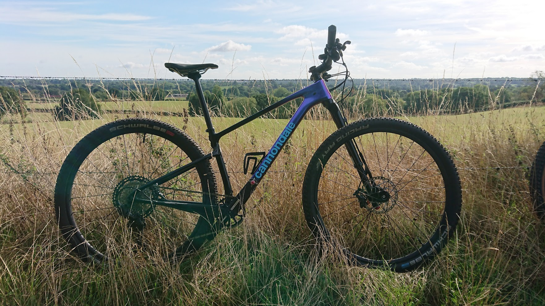

I've always liked the idea of having a bike built for me. I've just turned 66, so I thought that I'd better get on with it or I wouldn't have any time left to enjoy it. I dropped into our local framebuilder and had a chat to see if they would be interested in doing the bike that I wanted, because I knew they didn't usually do things like that. They seemed keen, so the next step was to book a consultation. I turned up the next week with two of my current bikes, the Sanderson Soloist 853 and the Cannondale Scalpel HT.
ย image.png The Soloist is a 26er and is a lovely bike, but just feeling a bit dated. I explained that what I wanted was a singlespeed with the character of the Soloist but the handling of the Scalpel. In addition, I wanted to know if they could accommodate my other ideas - EBB (if possible the same as the Sanderson one), belt drive, convertible to Rohloff should I get too old to push a singlespeed, able to take a 100mm fork and a dropper if I wanted. We kicked a few ideas around and decided that the best way to get the Rohloff compatibility was to use Paragon swappable dropouts, which meant that the EBB wasn't necessary. Belt drive was fine, but it limited the choice of cranks and in the end we settled on Rotor, with the gearing to be equivalent to 2:1 on a 26er since that was what I was used to. Dropper compatibility and 100mm corrected fork no problem. I wanted Hope Pro 5 hubs with the rear being the SS/T version, with Crest rims, Hope headset and BB, Renthal stem and bars, Hope seatpost, and XTR Race brakes. Even I found the Enve fork a bit steep, but the Kinesis a bit agricultural, so we settled on the Whiskey as a compromise.
