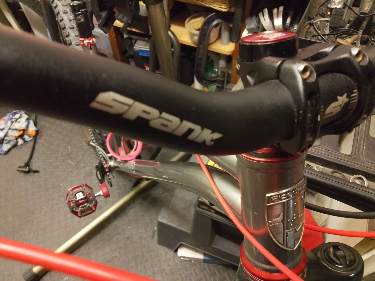

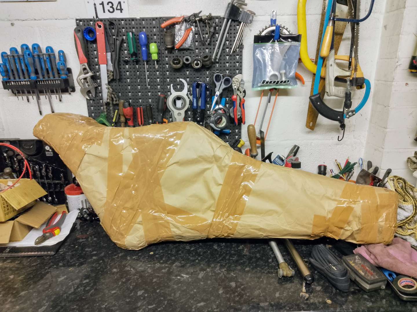

Can you tell what it is?
Not had one wrapped like that before!

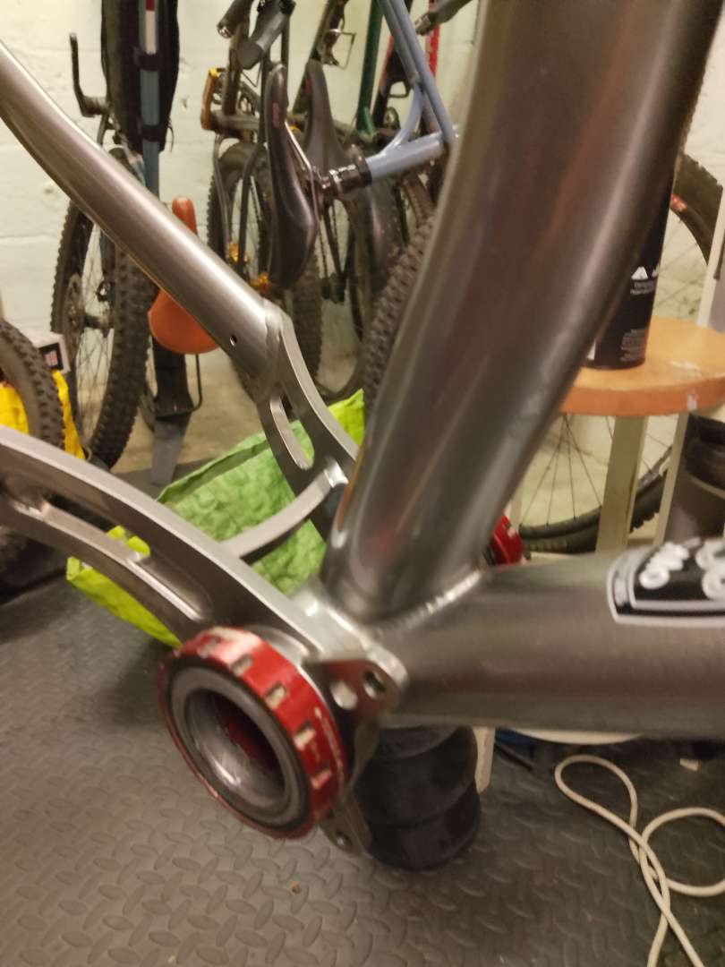

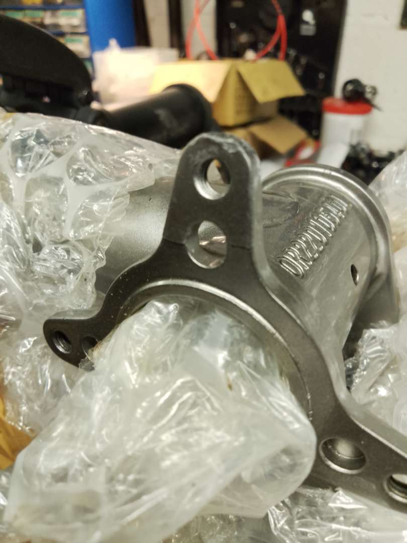

Luckily it seems to have survived (apart from a bent ISCG tab ☹️)

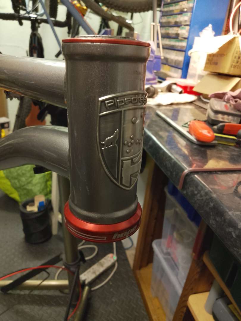

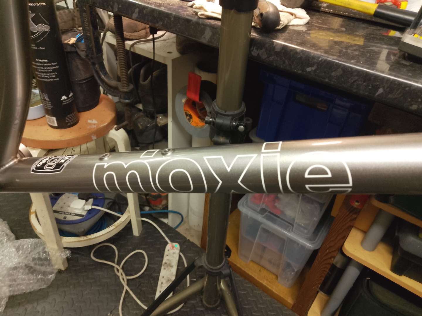

Mmmm, silvery
Couple of red bits fitted...
Posted : 02/09/2025 4:53 pm
Alex, reeksy and hardtailonly reacted

Nice! Did the ISCG tab just straighten back out again?
Posted : 02/09/2025 5:26 pm

I'm not using a chain device, so left it for now.
It's steel though, so should straighten out easily if needed.

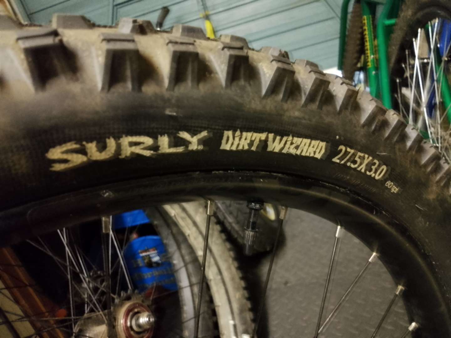

Very nice. What are you building it up with?

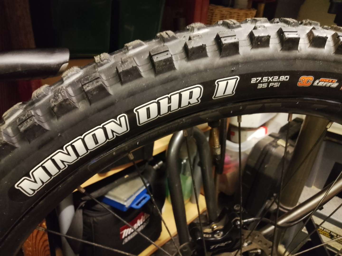

😎 Mostly bits from my old Ragley Bluepig + a few bits from the spares bin.
RS Revelation 150mm forks with a charger 2.1 upgrade (so basically a Pike).
Mixed Microshift and Shimano 11spd gears.
Hope BB, HS, seat clamp and Pro 4 27.5+ wheelset. TRP Evo brakes + bunch of other parts.
Full 27.5+, so 3.0f and 2.8r tyres.
Posted : 02/09/2025 6:03 pm

Chunky tyres, short (35mm) stem, 60mm rise bars and a few red accents. .
It's going to be a bit of a monster truck!
Posted : 02/09/2025 6:24 pm

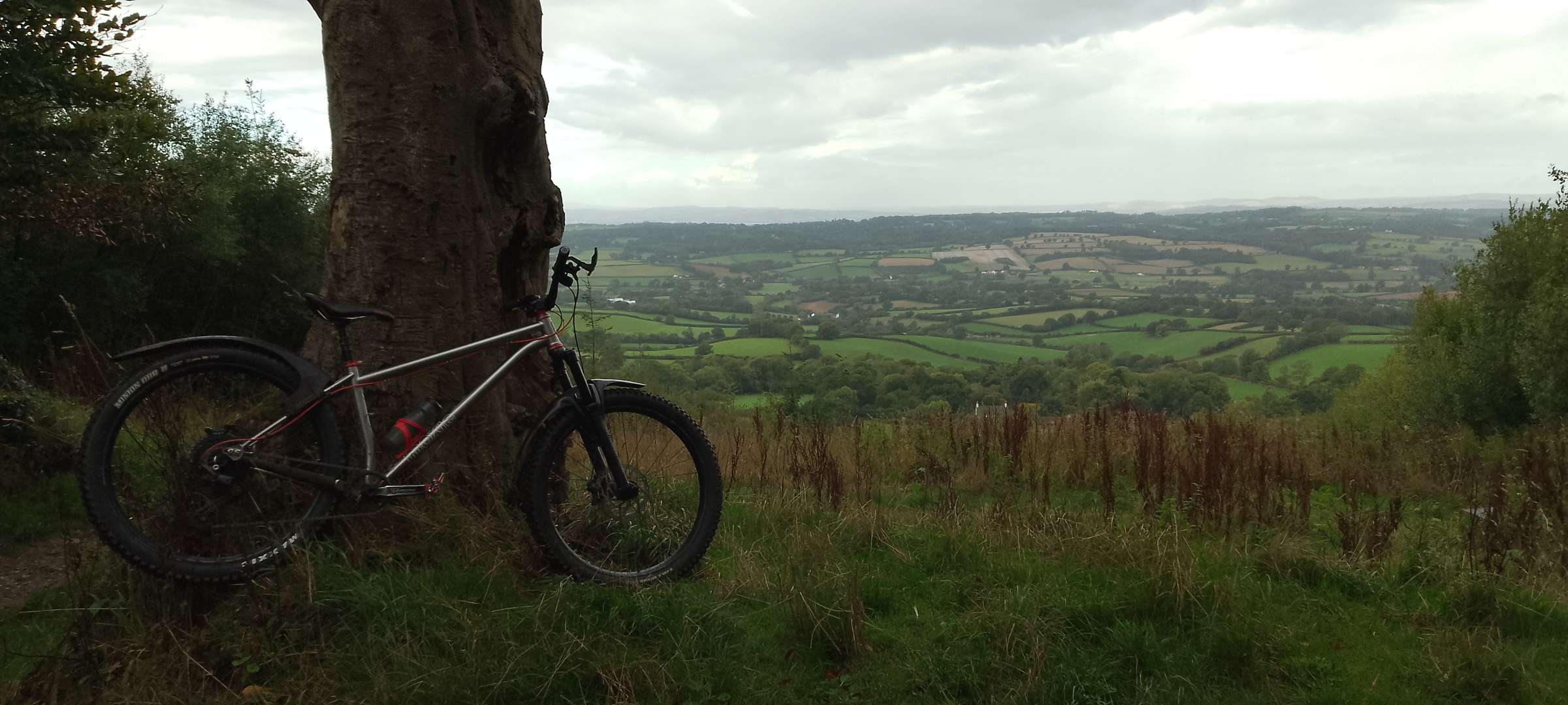

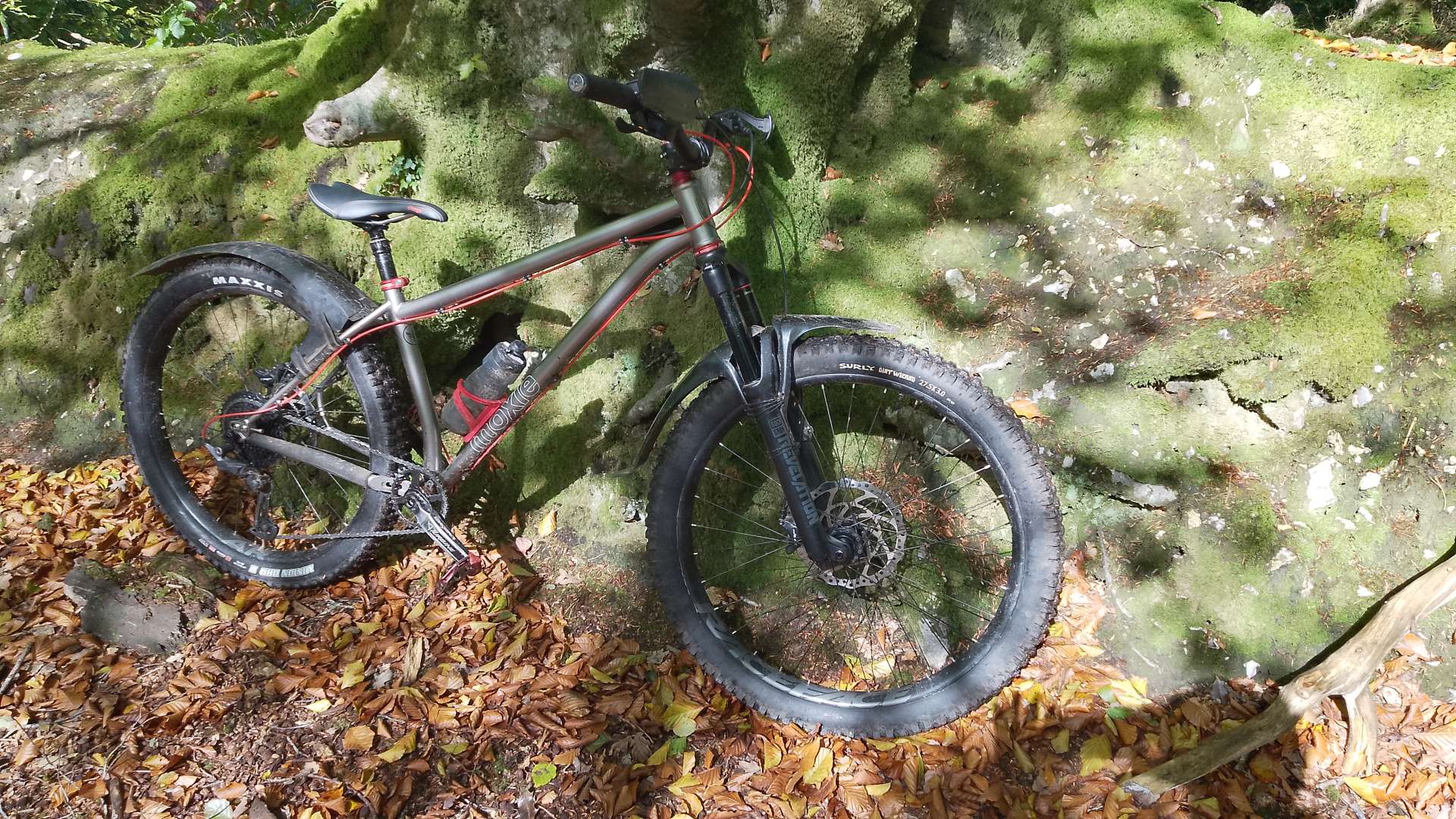

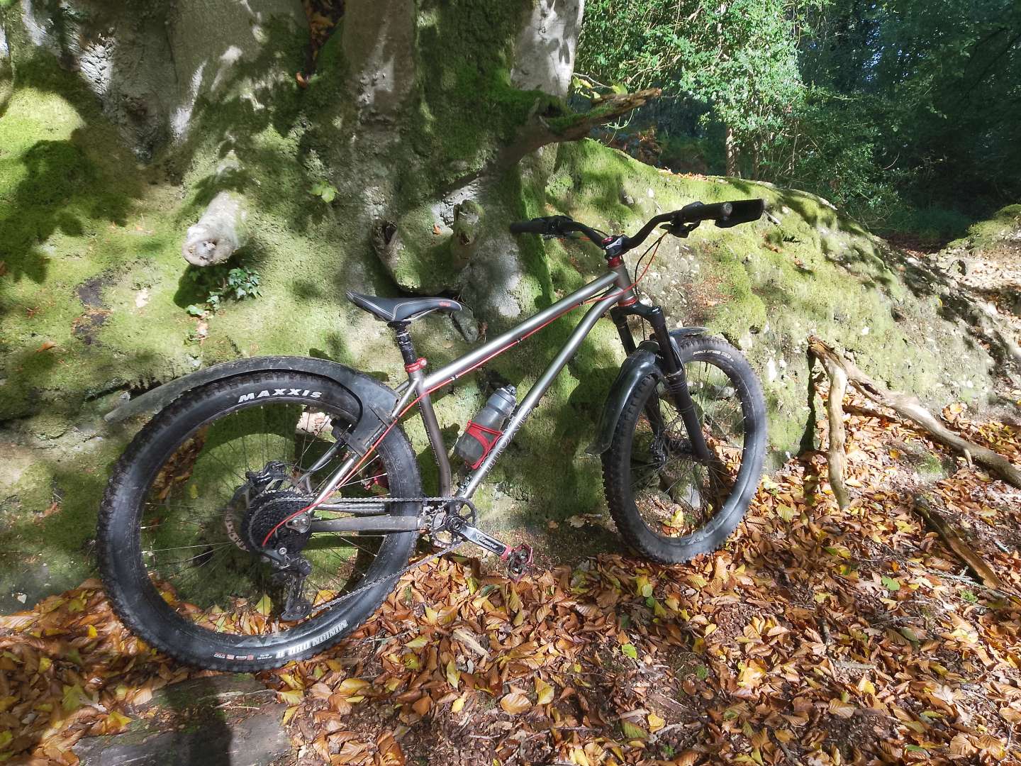

Finally got out for a proper shakedown ride - I was at SSUK last weekend so gears were a no-no 😁
What a hoot, stupidly capable on the downs, and climbs surprisingly well (steep seat tubes do work!).
Slight loose headset (that became apparent after a few km) that needs another 1-2mm of spacers, meant I didn't push it too hard on the downs.
Did a 40km xc loop with plenty of techy single-track. Lovely 😎
Posted : 13/09/2025 12:30 pm

those leaves need sweeping up. 😉

  • Did a 40km xc loop with plenty of techy single-track. Lovely”
This is something I find my Moxie is so good at - it feels great on long pedally rides (even though it’s not light) and on the most technical trails I have the skill to ride, so whatever I do it never feels like I’m on the wrong bike.
P.S. I’m not sure why you were waiting for it to stop raining - did you forget it’s got ENORMOUS mudguards? 😉
