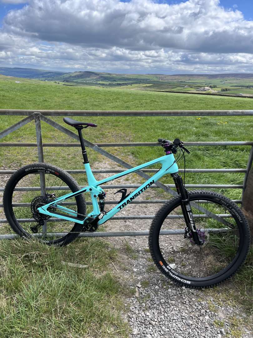

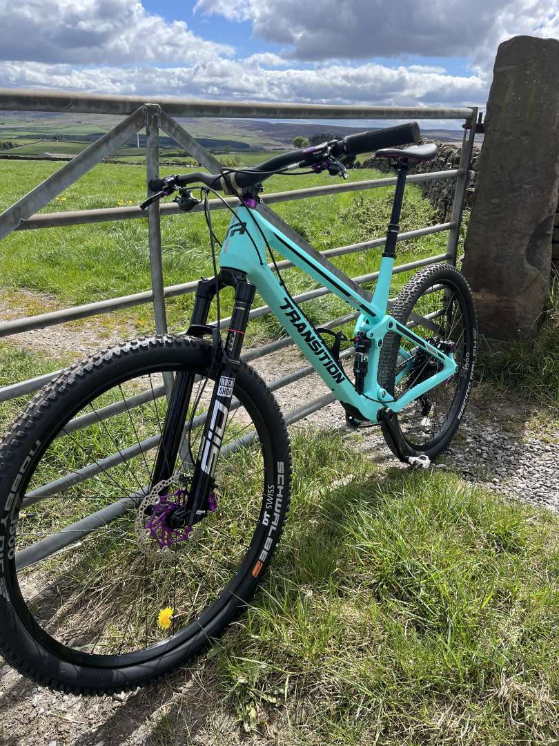

Been after a light XC bike since I sold my carbon Cube HT that had replaced my Ragley gravel bike. After much deliberation, heavy flirting with a Specialized Epic and help from you lot via another thread I landed on a new Spur frame for a good price. The initial plan was to build it with most of the parts from my Pace HT but as tends to happen it's ended up as a pretty much new build. Carried over were the dropper, carbon bar, stem and pedals. I picked up some second hand DT wheels as I really want carbon but don't want to pay for them atm! After that it's XT group set, Hope Tech 4 E4, Hope headset and SID Ultimate forks.
Took it out for a shake down run yesterday and am happy to report it is exactly what I wanted it to be. Don't know what it weighs but it flies up hill and feels really smooth and quick. I've not had a multi link FS before and it feels very plush out back, so much so that the front feels a bit harsh so there's fettling to be done. Just the job for the long XC days in the Dales I have planned!
Best of all I have managed to cobble together enough parts to keep the Pace running so this is N+1! BTW, purple was correct in the 90's and is still correct now.

Posts: 4004
Posted by: chestrockwell
It's worth dropping the fork lowers and doing a lower leg + air spring service, even if they are new. My SIDs improved noticeably after the first 50 hour service.
Also, from memory, you picked them up through a PSA on here and they're the older / v1 version with the Charger Race Day damper as opposed to the newer 3P damper? The ramp up on those v1s is very progressive, so much so that it's borderline impossible to get the last 20mm of travel. With a bit of experimentation though you will be able to get the initial stroke set up nice and plush (for an XC fork).
Posted : 04/05/2025 9:57 pm
Posts: 7018
Posted by: devash
Cheers mate. Yeah, set up as they are I have plenty of sag so was worried about dropping the pressure too much and blowing through the travel so I need to experiment. I have similar age Pike on my HT which are lovely and smooth so was a bit surprised by these tbh and was blaming the lack of compression adjustment. Might look to change them if they don't loosen up but really like how light the front end is so improving them without a weight penalty might be a problem (although I've not really checked the competition)?
