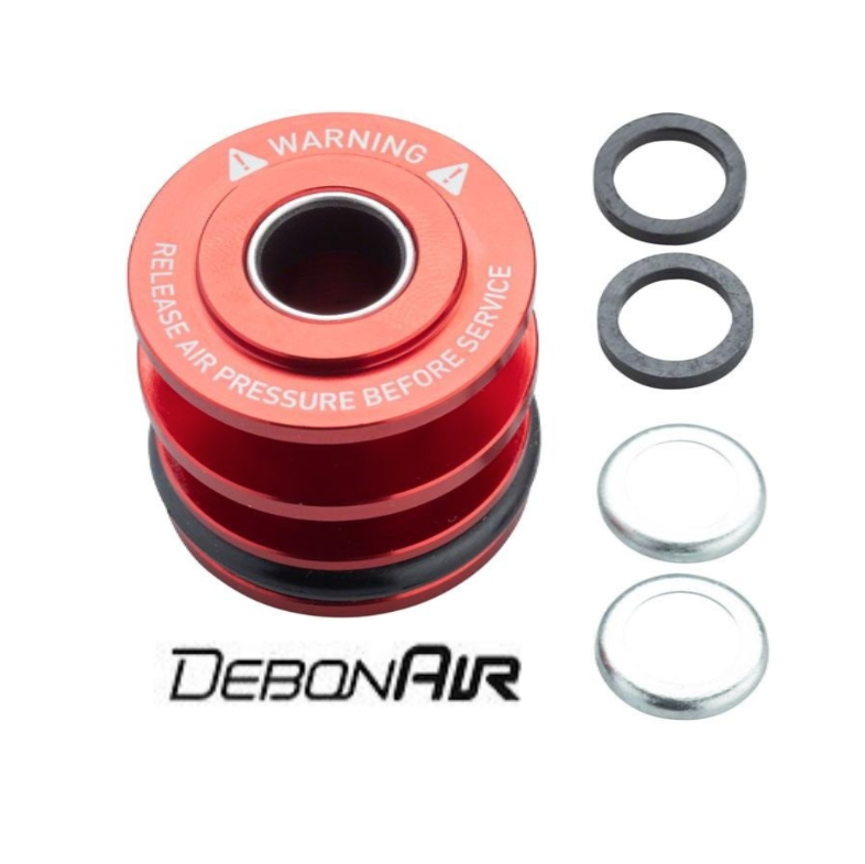

I’m guessing there’s no way of dropping a DebonAir spring in a 32mm fork?
Posted : 15/03/2020 9:31 pm
Posts: 14040
Seems to exist for the 32mm forks.....
https://cyclinic.com.au/products/rockshox-air-spring-upgrade-kit-reba-sid-debonair-2013-2020
