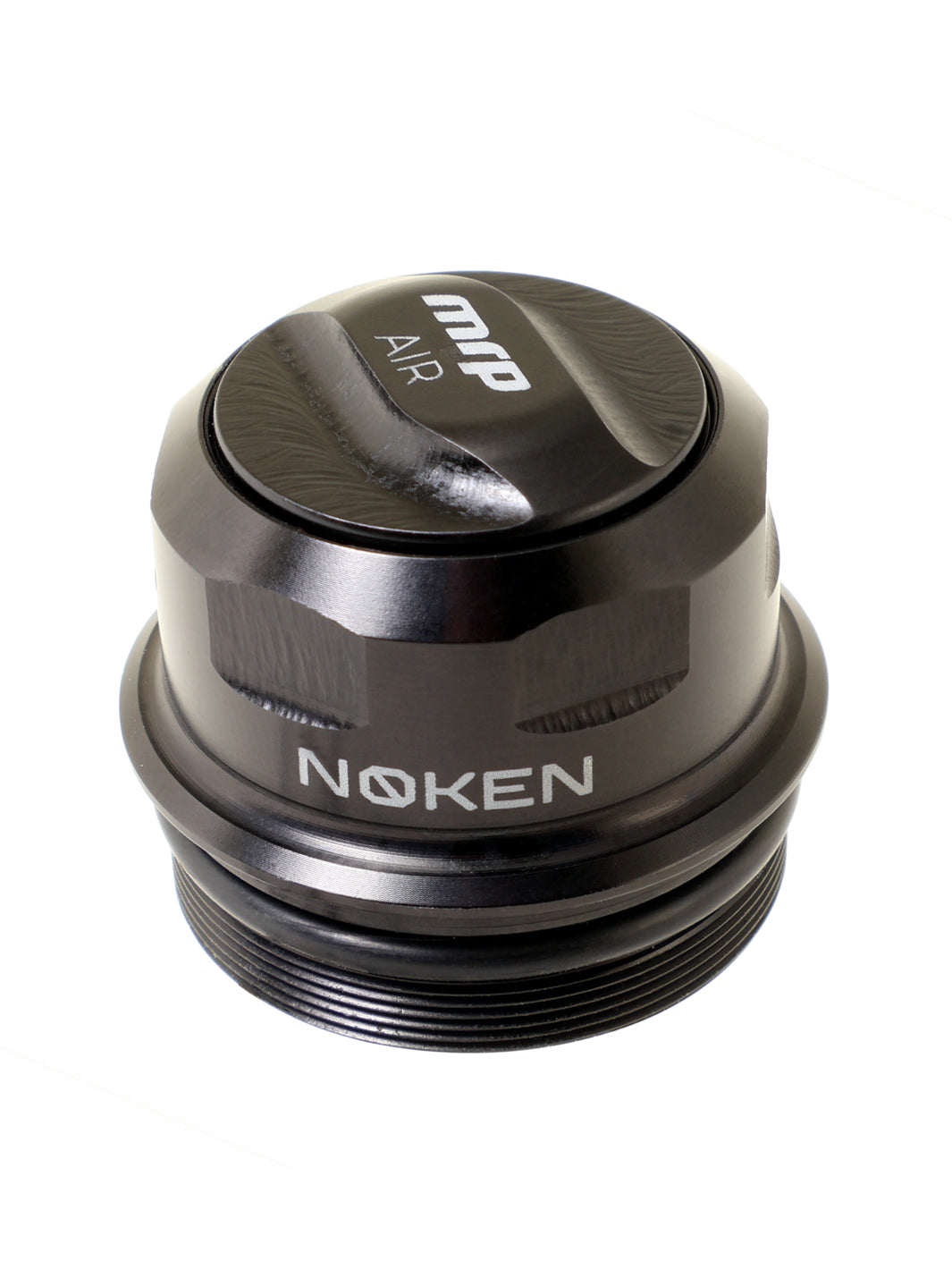

Can't believe I didn't know this existed but then I can't see it for sale in the UK.  I'm a 70kg sub average rider so long travel forks tend to ramp up more than I need/want.  Trutune cartridges are a great solution but I worry a little that they may degrade over time.  This MRP Noken appears to be a very simple alternative with very little to go wrong so long as I have clearance for the extra height on the fork leg.  Anyone tried one?

So many clearance issues with modern forks on bigger travel frames, I can't see that this has much of a particular window of opportunity amongst those who would benefit from it most!
I do like the idea though... Most modern forks do have far too progressive a main air spring as a result of longer travel, larger negative air springs etc... But it will be crucial to check if this will fit on your bike first!!!

I have one fitted to a 170mm travel Zeb. I have always struggled to get full travel with these forks, the noken has not really helped that much, only a slight change; seems like the ramp up in the lower legs is more significant.
I might try fitting the older air spring without the buttercups and see if that helps.
Ah, that's a shame.  Obviously not a huge volume to the Noken but I was hoping it was significant enough relative to the air spring size.  Hopefully my frame won't have enough clearance and I will be saved from the temptation to try one anyway
I see they offer a 'riser crown race' in 5mm and 10mm sizes to increase clearance but that is not a route I wish to take

Noken is a great idea and a visible extra air volume unlike Trutune which you can't actually see (it's all theory, plus how long will it be effective). I already have Trutune and it's like taking out one more token. I nearly ordered a Noken from the States until I realised that it has no nub to fit the Trutune to. In other words it's one or the other.
