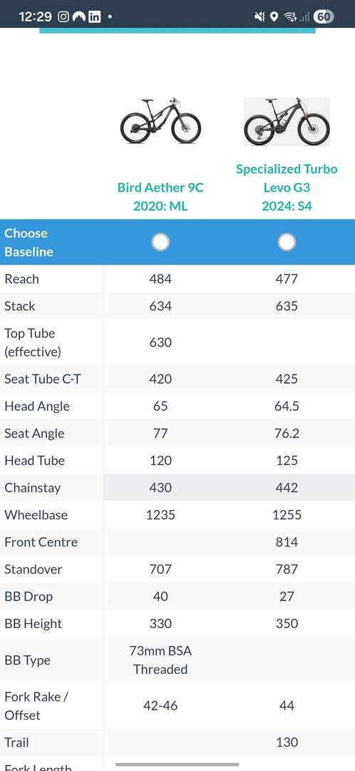

I've got a Bird Aether 9 medium long and a large 2020 Orbea Wild. The Wild was second hand used wet and has blotted it's copybook a couple of times leaving me almost stranded. It also feels very unwieldy in anything other than winch and plummet, I probably don't need 38s.  The bird fits me great, standover and reach are perfect.
I'm in the market for a replacement full fat eeb, preferably used. What frame has similar geometry to the Bird M-L or at least the lowest standover?

A Gen 3 Levo isn't wildly different, albeit a bit less standover.

The S4 is 7mm shorter reach than your Aether, but I have a 42mm stem on mine over the standard 35mm, so puts it pretty much the same effective reach barring a bit of pedantry about angles, spacers and other such. Specs vary massively from Comp to S-Works though so worth doing a bit of research

Try looking at Large sizes. My large Trek Rail+ has, I think 10mm longer reach than my Aeris 9.
With a 32mm stem, vs the 45mm supplied it feels perfect for me.
Don’t know the stand over numbers, but at 183cm tall, the 200mm dropper has a few cm of post to the collar.
