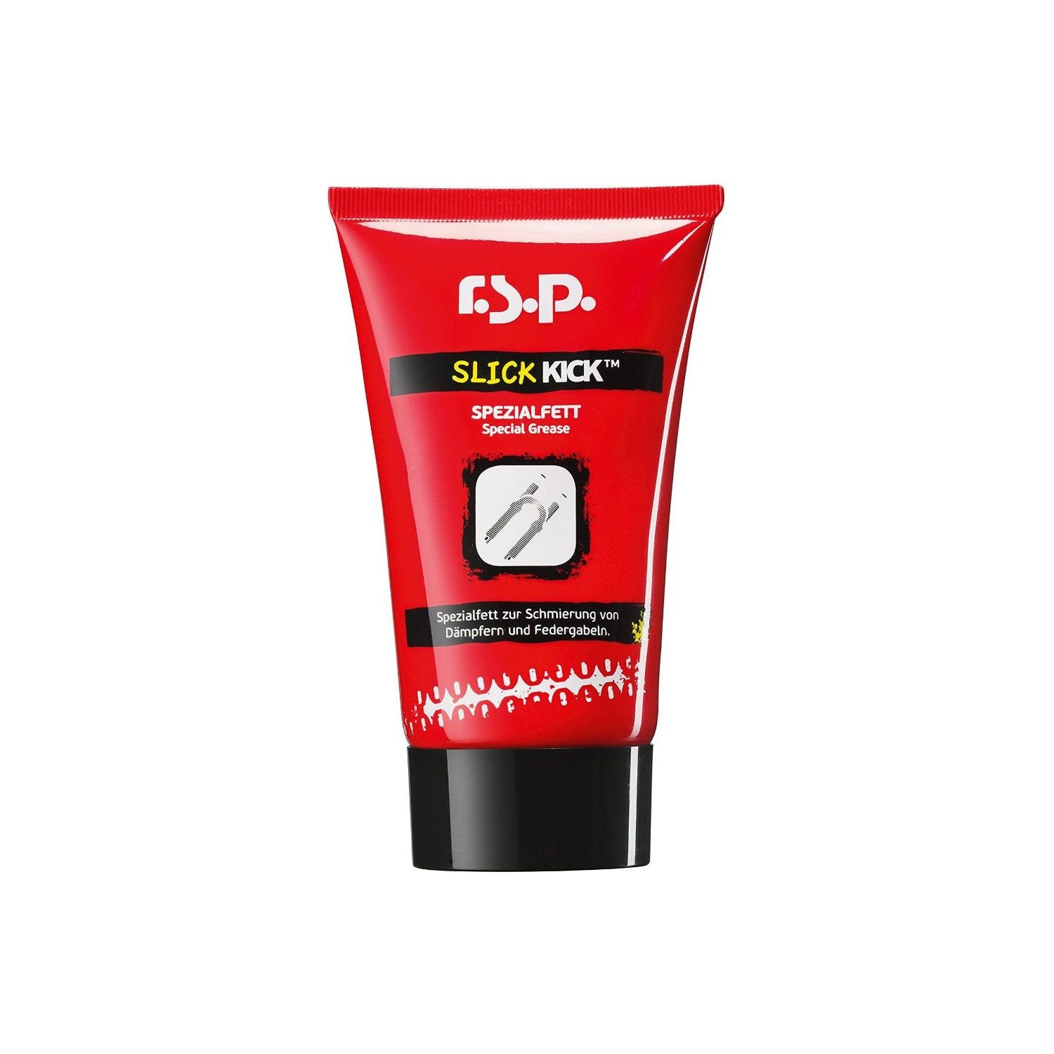

RSP Slick Kick is a fine alternative.
Dunno if you still consider it a rip-off though?
Posted : 07/06/2022 5:40 pm
Posts: 818
I use RSP Slick Kick.
https://j-techsuspension.co.uk/products/rsp-slick-kick-grease?variant=30612107100300
Posted : 07/06/2022 5:41 pm

£25 for a 500g tub of rsp slik kick at j-tech tuning.
I use it on forks, shocks and dropper posts. That tub should last me basically forever.
Posted : 07/06/2022 7:09 pm

I've got the RSP stuff.
Posted : 08/06/2022 10:43 am
Posts: 1797
+1 for rsp slik kick. I bought a big tub for £25 years ago and I've barely made a dent in it.
Posted : 08/06/2022 10:52 am

I'm still working my way through a 50g tube of RSP Slik Kick, but when I eventually run out I'll give this a shot. Cheers.
