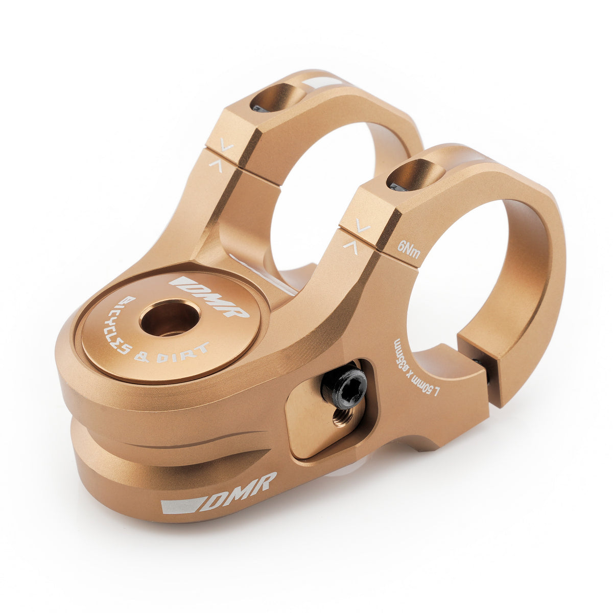

Posts: 4105
DMR Defy is 31mm stack in 50mm length when i looked recently.
60 or 70mm is quite long.
Posted : 13/04/2021 11:52 am
Posts: 5661
DMR Defy may fit the bill:
• ø31.8mm clamp (Defy50) and ø35mm clamp (Defy50+) available
• CNC 6061 Alloy
• 31mm Stack height
• 50mm reach
• 5mm rise
• 189g
• Stem cap included
60/70mm is a long stem though...

Posts: 2931
i bought a defy for this reason - nice bit of kit. i like that there are no rear bolts to interface with your knees/bollox in the inevitable crashes.
