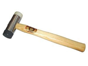

Not sure how I'm going to extract that yet.
The answer is nearly always* "thor soft face hammer"
*whilst my advice on adhesive was well founded, this particular advice may not be 😉
