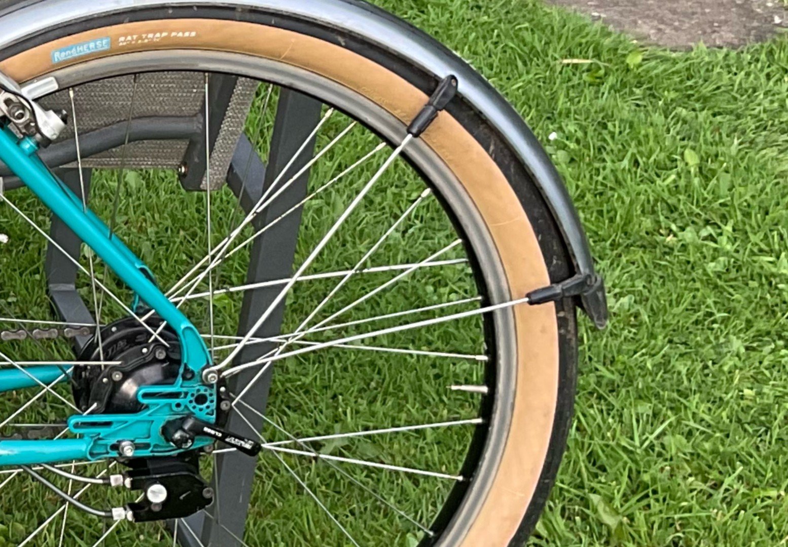

As for mudguards, I had a Surly Troll with mudguards and I put a QR mudguard thingy, like the ones that come from the front wheel, on the rear so I could unclip the back mudguard to give the wheel room to slide out.  That worked ok for a while but was a bit annoying as it got worn and less secure.  I then moved to the type of ‘guards and stays that have a plastic adjuster at the mudguard end.  They worked really well and it was easy to undo them to allow the wheel to come out.  I am only talking about occasional wheel removal for a commuter bike here mind. IMG_0036.png
