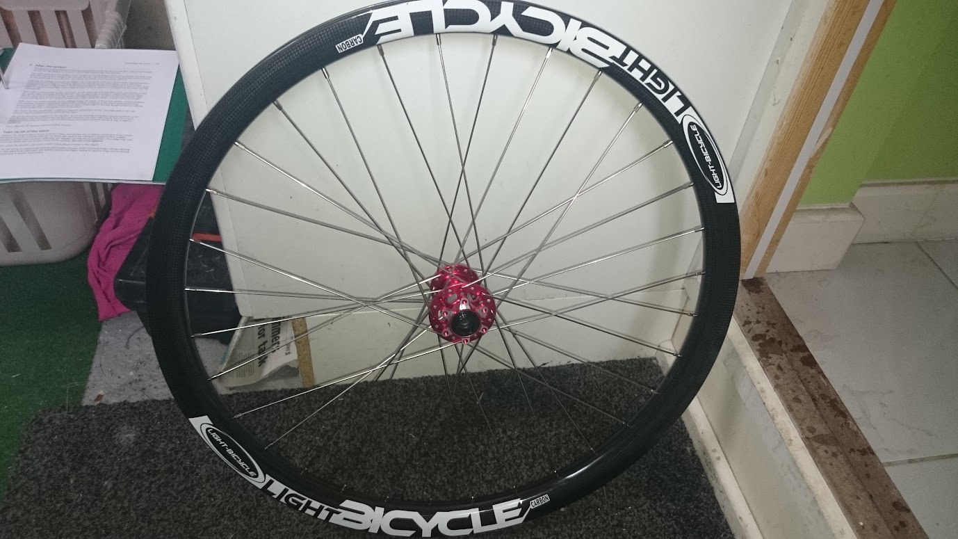

Got my rims today from the depot! £30 charge. Built the front up onto a Superstar Ultra Lite hub (15mm) with DT competition spokesx32, 14mm brass nipples. 806g without rim tape, valve+rotor. Pic of completed wheel tomorrow, but heres the rim and a comparison to Flow donor rim:
[url= http://www.light-bicycle.com/carbon-650b-rims-38mm-wide-hookless-mountain-bike-rims-tubeless-compatible.html#.VaWRY_lViko ]LB 38mm rim[/url]
[img] https://lh3.googleusercontent.com/fnisHCS1aThw-f7s4zZulMkqptRuGLVadNVjHRjbfGPl=w436-h775-no [/img]
[img] https://lh3.googleusercontent.com/3AGp381-Vv9lCYDFJ3a6z5qdGaiqkzhknOsXGapsC2di=w1378-h775-no [/img]
[img] https://lh3.googleusercontent.com/O5QsZF0zwdcSneXbO_aFVYLGPqnDDQca-kY7xWPFZ_T5=w436-h775-no [/img]
[img] https://lh3.googleusercontent.com/VrgFG82wZyON9qprOFCpeKpUqNbVAq4erTm7zBBkcL8z=w436-h775-no [/img]
They are massive in comparison to the Flow!

Like their new graphics. Still getting tempted to try their road rims

How did the ERD match up against the published ones when you came to do the build?
Posted : 15/07/2015 8:05 am
Posts: 3225
They quote the ERD as 535mm. I measured at 529/530mm internally (not the most accurate measurement), but I think the ERD should be to where the nipple sits inside the rim, so maybe +4mm. I would need a piece of string with a knot in or similar to measure. My spokes were fine though, which I ordered prior to rims arriving. 260mm x 48 and 262 x 16 (although not built the rear yet).
Wow aren't they just. 😯
Posted : 15/07/2015 8:41 am
Posts: 7941
To think, back in the day before Stan's rims were ubiquitous, the light but wide Flow was something of a curiosity, and pretty wide even by DH standards!
It looks pitiful in those pictures.
Posted : 15/07/2015 9:38 am
The 38mm rim depth make the 650b light bicycles look like 26" rims. It's a bizarre optical illusion, a side effect of making the trails come alive.
