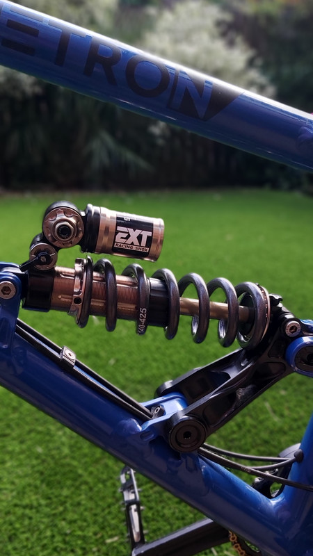

Just because I like to bring closure to a thread rather than leave it hanging,
I now have this.
Storia
More importantly I think I've managed to flick the switch in my brain which was keeping me locked in the house.
I've been out for a couple of local rides, just around the streets and parks to see if my legs still work.  It feels, er fine. I won't really know until I take it off road which won't be until the weekend.  It feels very quiet and very planted.
If I want to rant or rave about it I'll probably post in the Geometron megathread as there's other users in there.
Now I just want some fun riders under my belt.
