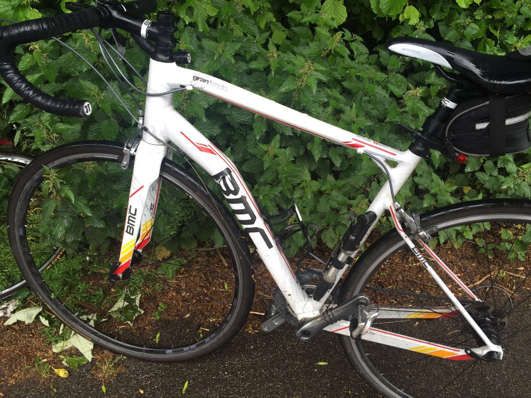

Posts: 1014
My friend crashed his road bike into the back of a ambulance (long story) anyhoo ally frame was folded but the carbon fork were perfect not even a crack
crash
That's the problem. They'll look perfectly fine until they snap off.
