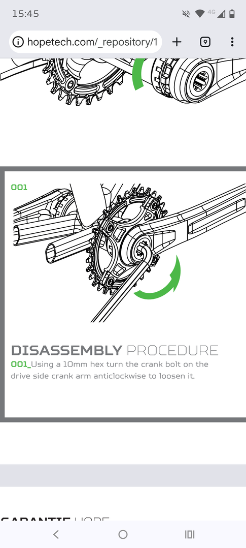

Massive 10mm Allen key 50kg wife standing on the cranks and is cannot shift this bolt.
I've slathered all the bits I can get at in WD40 over night and it's still stuck.
Hope video shows someone effortlessly undoing this bolt.

Just had a quick look at Hope's tech. documents and the required torque for those bolts is 50Nm, which is fairly hefty even if the previous owner hasn't overcooked it. Even if the bolt's free I think it'll require a reasonable amount of heft.
I have some hex heads on 3/4" sockets which are handy for snapping into my cheap Draper breaker bar (I'd guess it was about 60cm long). Hopefully the bolt's free to move (not seized) and you just need to get it moving.
