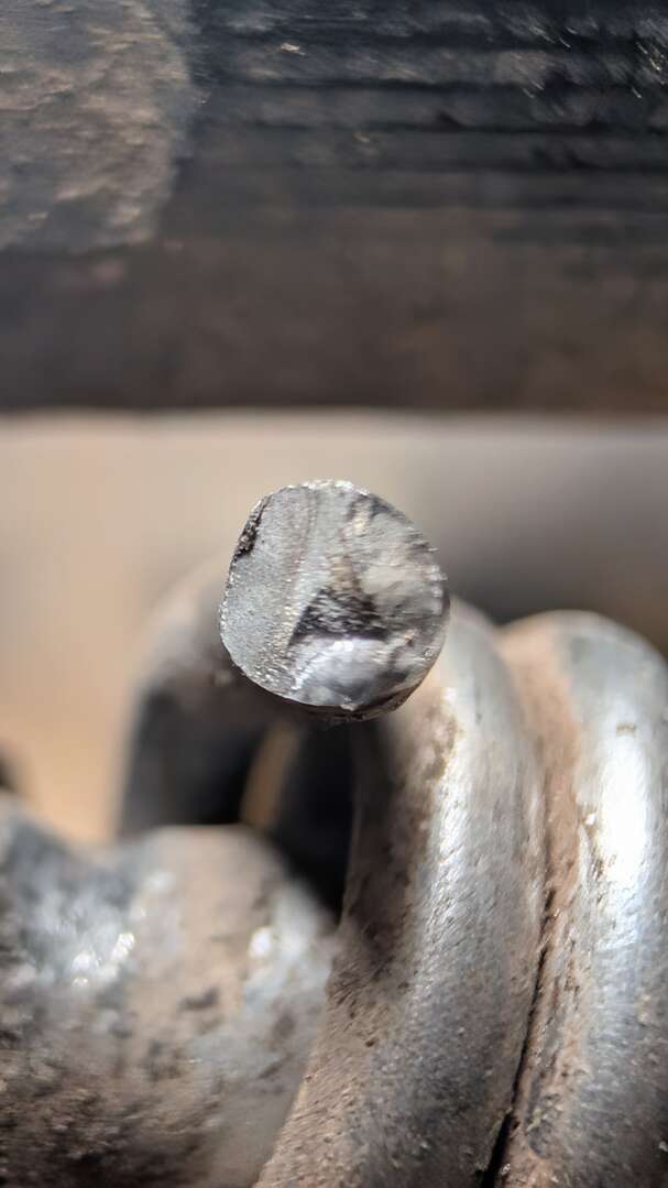

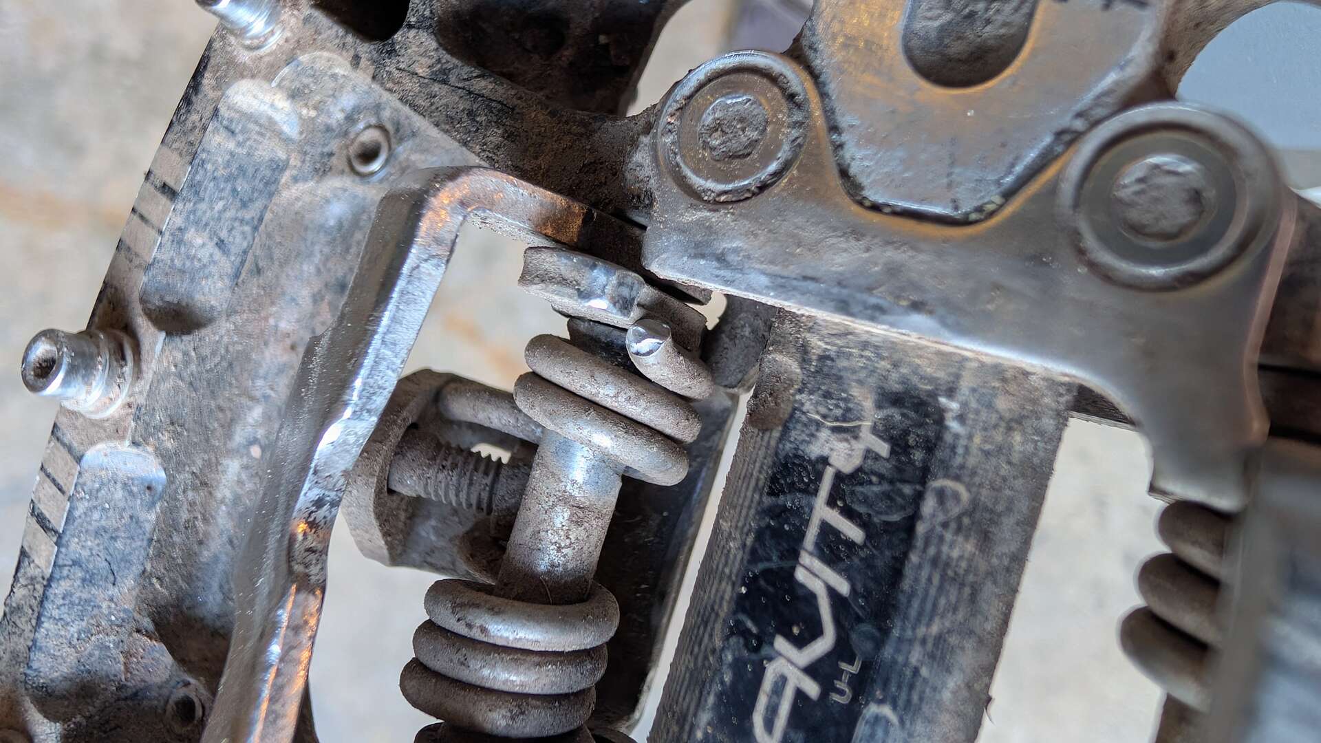

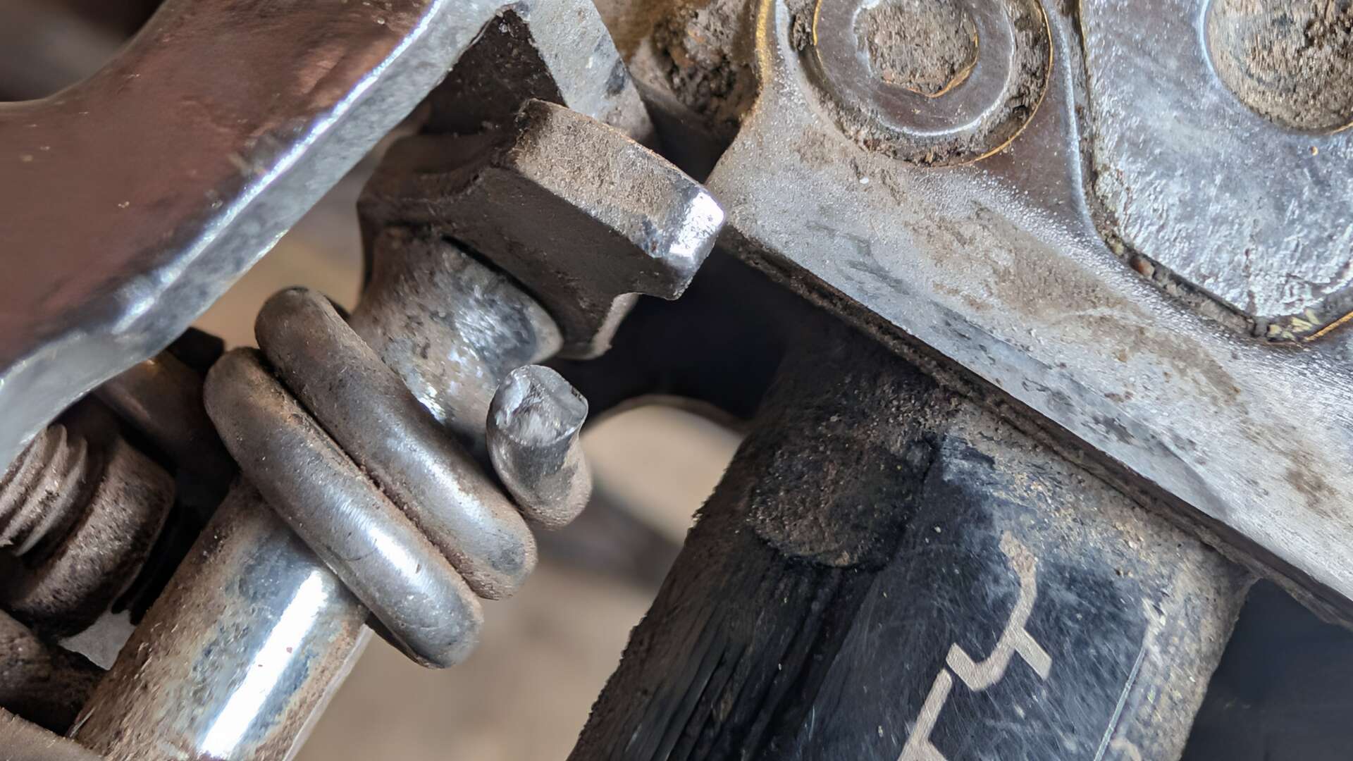

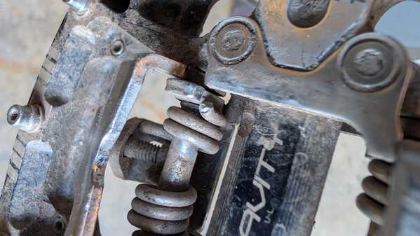

Looks like I spoke too soon about the condition and possible longevity of the Hope Union GC pedals.
One of the springs snapped this weekend ☹️. Looks like the something has rubbed the spring, I'm guessing the cleat, and created a stress riser. (The almond shape on the end of the spring looks like the area of rub)
2 1/2 years old so no warranty.

I'll send Hope a message and see what they say. After having a closer look, it looks like the spring has rubbed on a plate, gradually started to crack and the finally gone.
