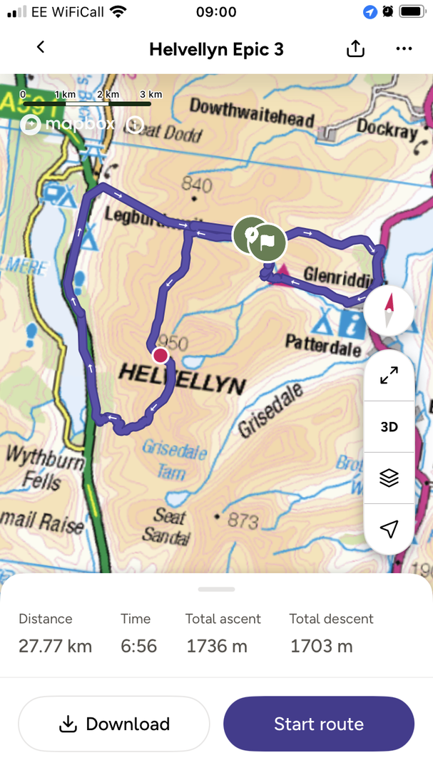

 IMG_7699.png Hi. Inspired by this thread and thinking about Helvellyn this Friday and a first to Lakes other than Whinlatter (Sad face).
From what I can work out Seldom Seen and Birkside are the best ways down - one flow and one tech. Two route options starting and ending at Glenridding to go up behind the youth hostel and along sticks before heading south and down Birkside. Then either up from Dunmail Rise or ride north to ride back up and along sticks and finishing on Seldom…
Questions:
1. Is this doable in a good day? Most the team is fit and/or assisted. Hours needed?
2. Which is the more rideable or advisable climb back from Thirlmere, Dunmail or Sticks Pass? Concerned that Dunmail will have lots of carry and 50% of the team on E - they would like the least push or carry.
I drew a picture of the route below.
xx
Yes. I did a variation on this where I climbed Dodds Ridge rather than Sticks west. I have to admit that I was very tired by the time we did the second ascent. Total time was 7hr 21

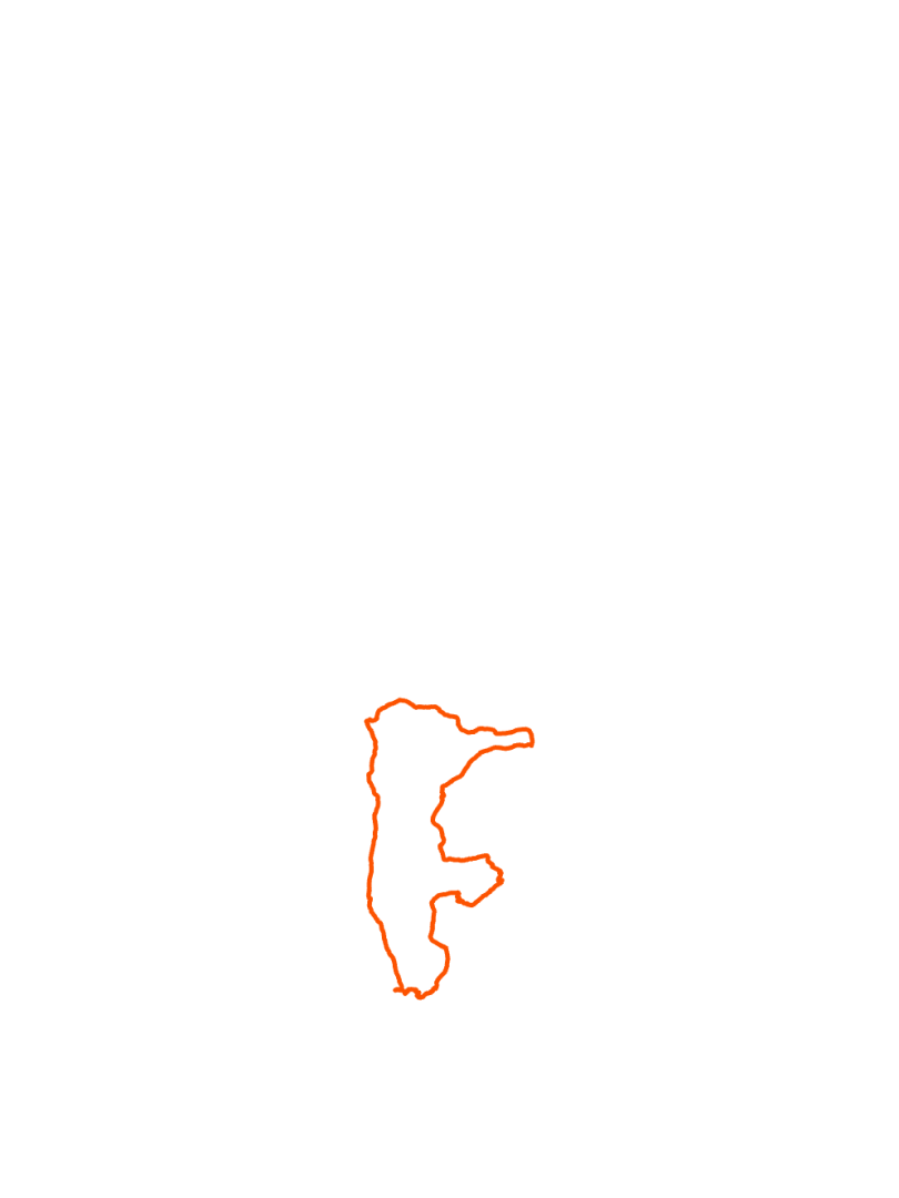

  https://strava.app.link/4pvpdF2Z42b
I've not done either but Rich the Keswick guide did Sticks West on his eeb recently and deemed it good. Dunmail etc would be a mare with eebs. Deffo do Sticks West or the other bridleway near it.
Also, although you didn't ask, can I suggest you change your Sticks East up to  Keppel up. ( As the poster above suggested) as it would be much more rideable on an eeb.
Posted : 12/05/2026 12:47 pm
mashkins reacted
Posts: 766
Posted by: mashkins
I'd say sticks up from the west, especially if you're eebing with walk assist. Actually I wouldn't be surprised if some fit folk can clean the steep bit of the climb (and therefore the whole thing) in the dry with a motor. The middle section can be boggy but probably not too bad currently. Top bit nice riding, bottom bit rideable, middle bit steep and grassy but straightforward by lakes standards.
  • Edit - crossed posts with @thegeneralist above. But totally agree and assumed that was the plan - keppel up, birkside down, sticks up from the west and sticks down to the east. Especially with eebs you can probs ride everything up
Posted : 12/05/2026 12:48 pm

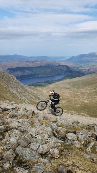

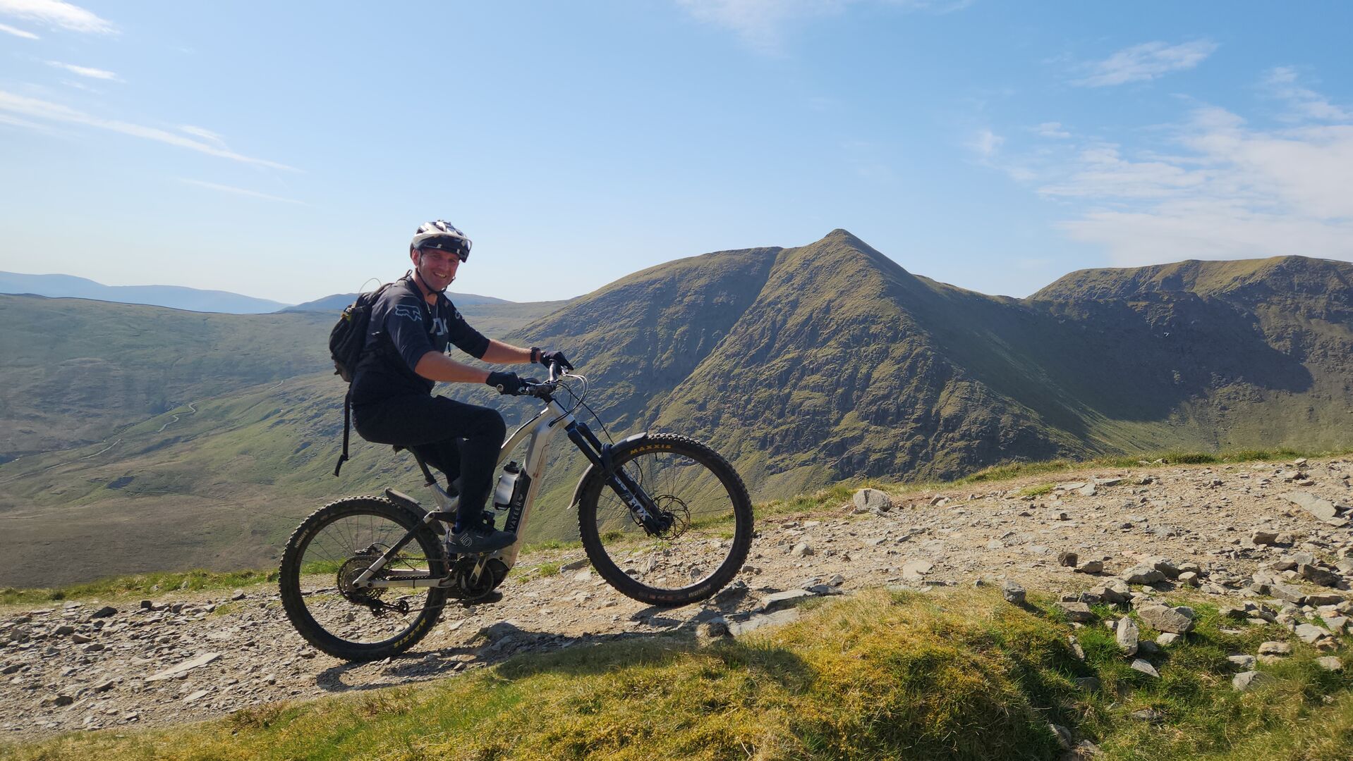

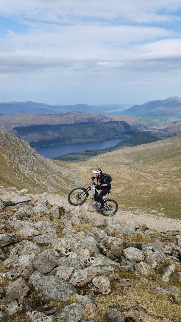

I rode Helvellyn 10 days ago on an Eeeb. Was a simple up Keppel/Whiteside and down Sticks. Was a 2 meter rock step at top of Lower man where I had to dab but otherwise was 100% rideable. I did however rinse my 630ah battery to 20 % so no way I would have been going down to Thirlmere and back up. One of best days on bike for a while. Perfect conditions and didn't meet a soul until the summit. Reckon that would be a seldom occurrence. 20260501_100610(0).jpg20260501_094337.jpg
