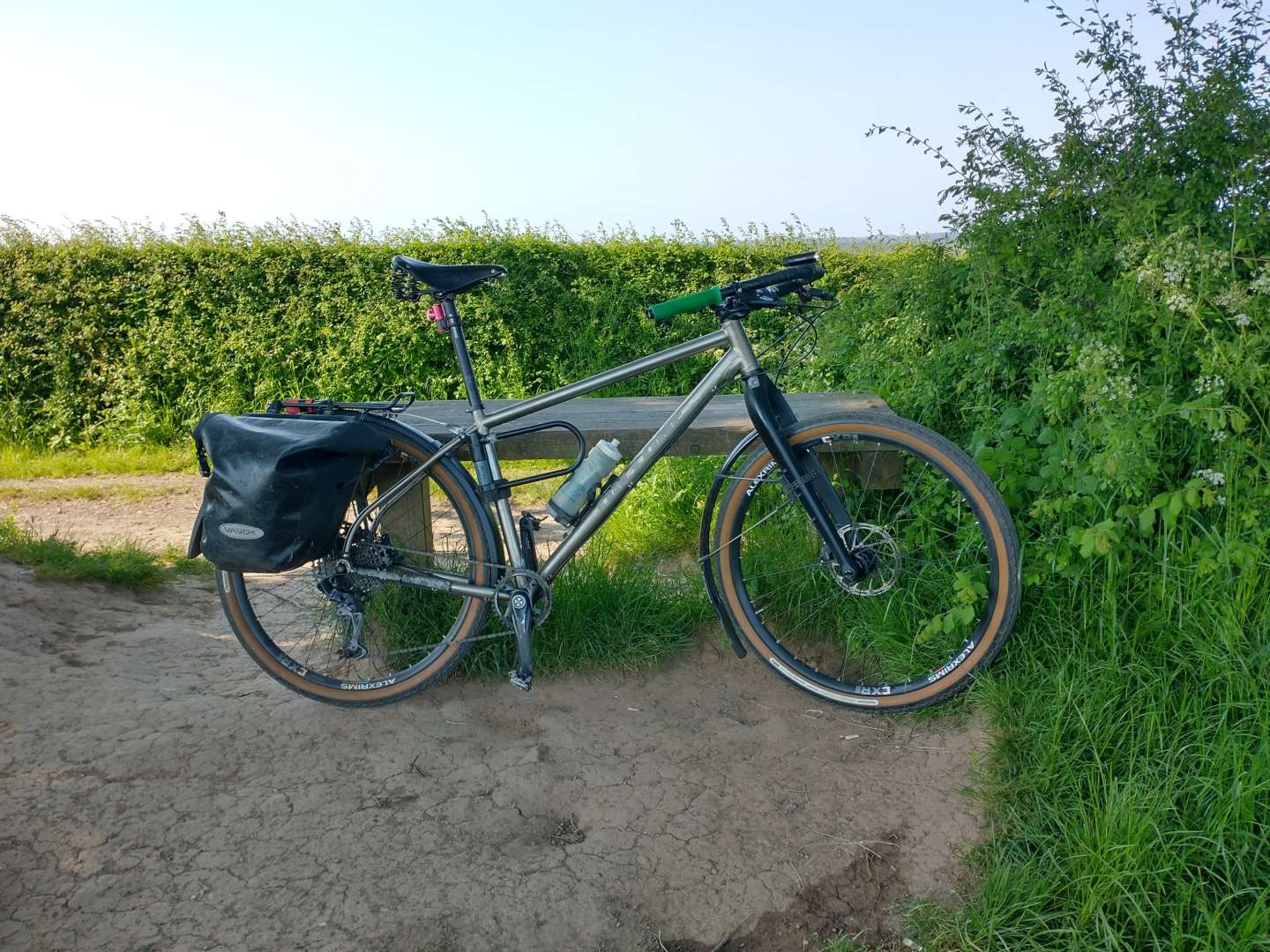

 I use an on one Vandal with no rack points as a commuter
P clips on the frame have been fine for the last couple of years.
Takes about 5kg most days.
The fork is a carbon bike packing one so the front mudguard bolts to the side bolts and I bodged a bridge. Two (long) hose clamps with a bit of steel in the middle drilled for the mudguard. The fork is an off shape so the clamps aren't quite flush all the way round, aesthetically poor but practically fine. IMG_20230609_164909716_HDR.jpg
