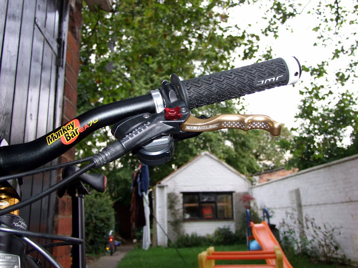

Ah, not as bling as my gold ones. A lot of money for levers, but they really do transform the brake.

Swiftacular - very nice set up. Gold is about as special as you can get, but my bike's orange and wouldn't look pretty.
