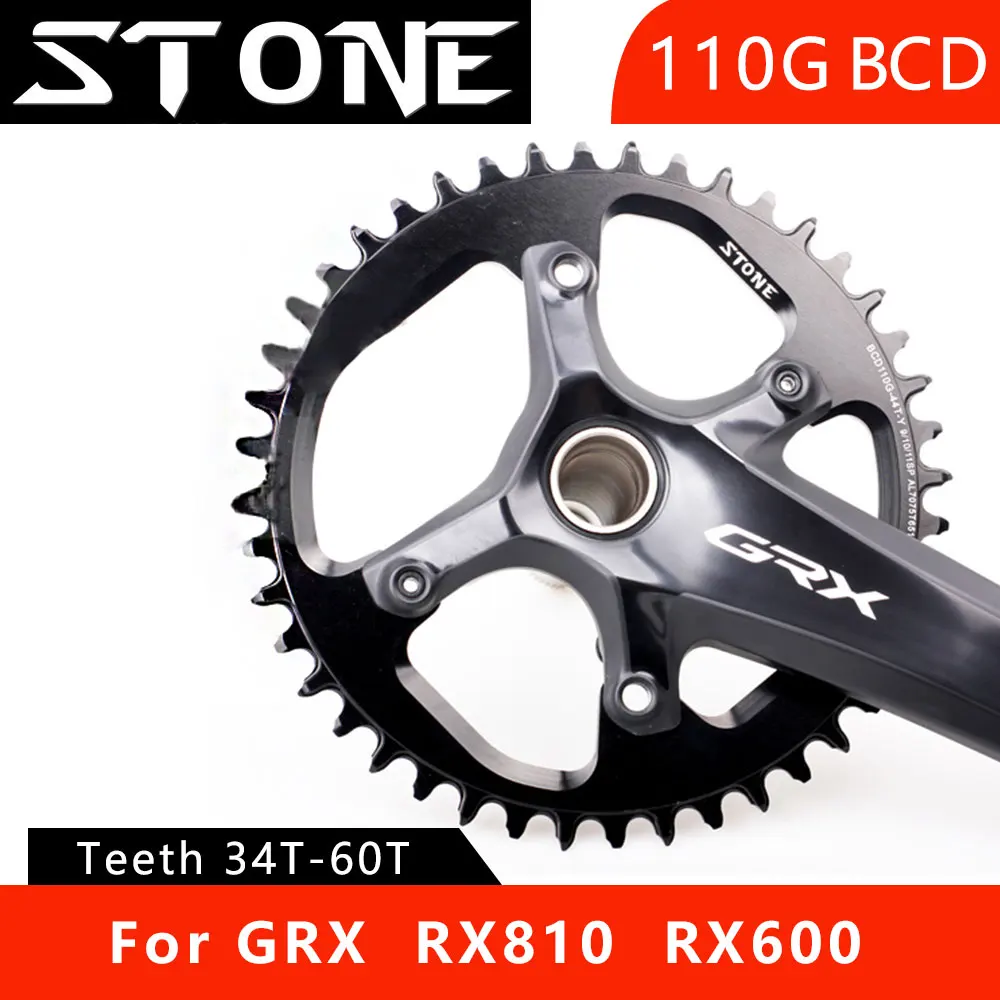

https://www.ebay.co.uk/itm/365255343480?mkcid=16&mkevt=1&mkrid=711-127632-2357-0&ssspo=u8wmfaroqwi&sssrc=4429486&ssuid=K5fGryJvQAe&var=634953707130&widget_ver=artemis&media=COPY
I have just purchased a 38t of this....they do down to 36t.
I'm sure there'll be a a GRX option
Posted : 19/02/2025 8:34 pm

I
Posted by: mikertroid
I've just bought one of those chainrings for Mrs LJ as they seemed to be the only 120 BCD option for the FSA chainset on her Marin Gestalt and its 42t ring. With the dinner plate cassette, she now has a 38-51 bottom gear, which very much suits her sit'n'spin preference. This entire exercise stems from one road climb from Symonds Yat up to the carpark at the Rock 😆
Posted : 20/02/2025 3:10 pm
