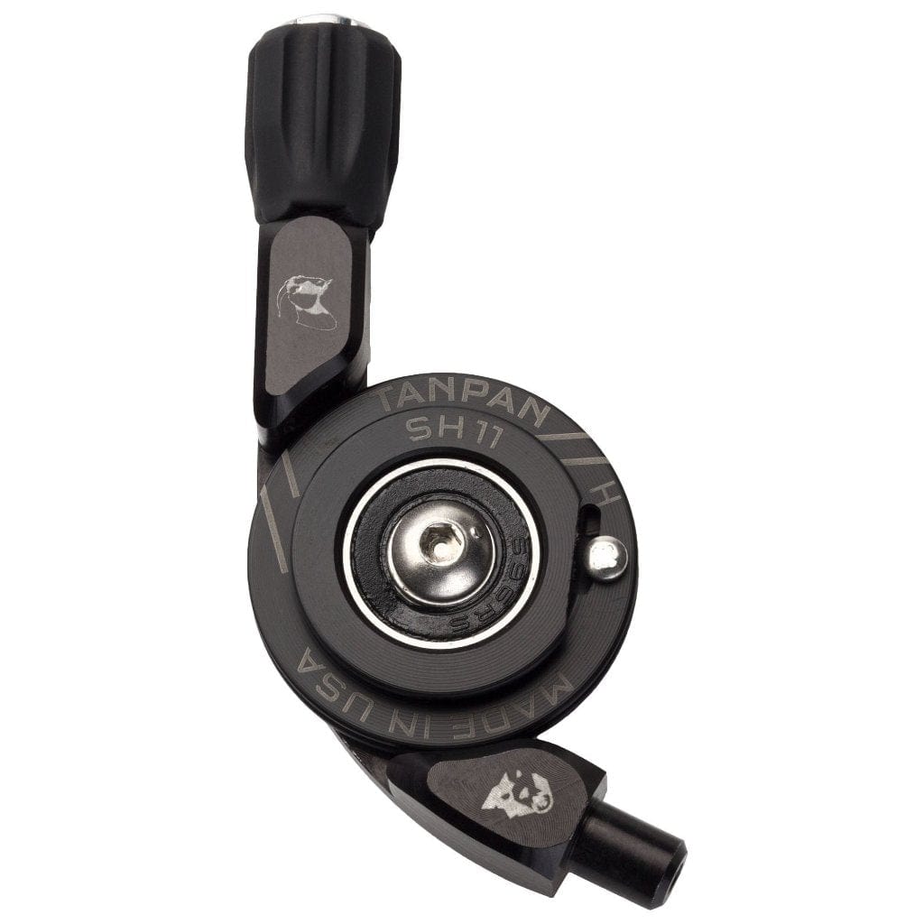

Posts: 3882
You could put a 10/11 spd MTB rear. Mech on with those shifters if you fit a Tanpan 10.
https://www.wolftoothcomponents.com/products/tanpan
Posted : 02/03/2021 9:52 am
